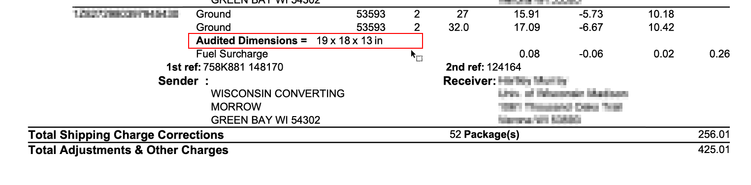

This is becoming more of an issue for us as LTL has dwindled due to COVID. Looking to see if anyone knows once you provide dimensions to manifest will UPS freight on those dimensions so we can avoid these stupid charges. This was for last week alone. It’s hard to go back and ask the customer for those differences so we eat them right now.
