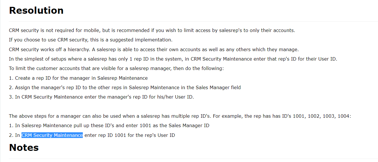

Epicor support keeps referencing CRM Security Maintenance but I don’t see that as a program in E10. Anyone have experience with Epicor Mobile CRM security? We want to restrict what a sales rep can see.

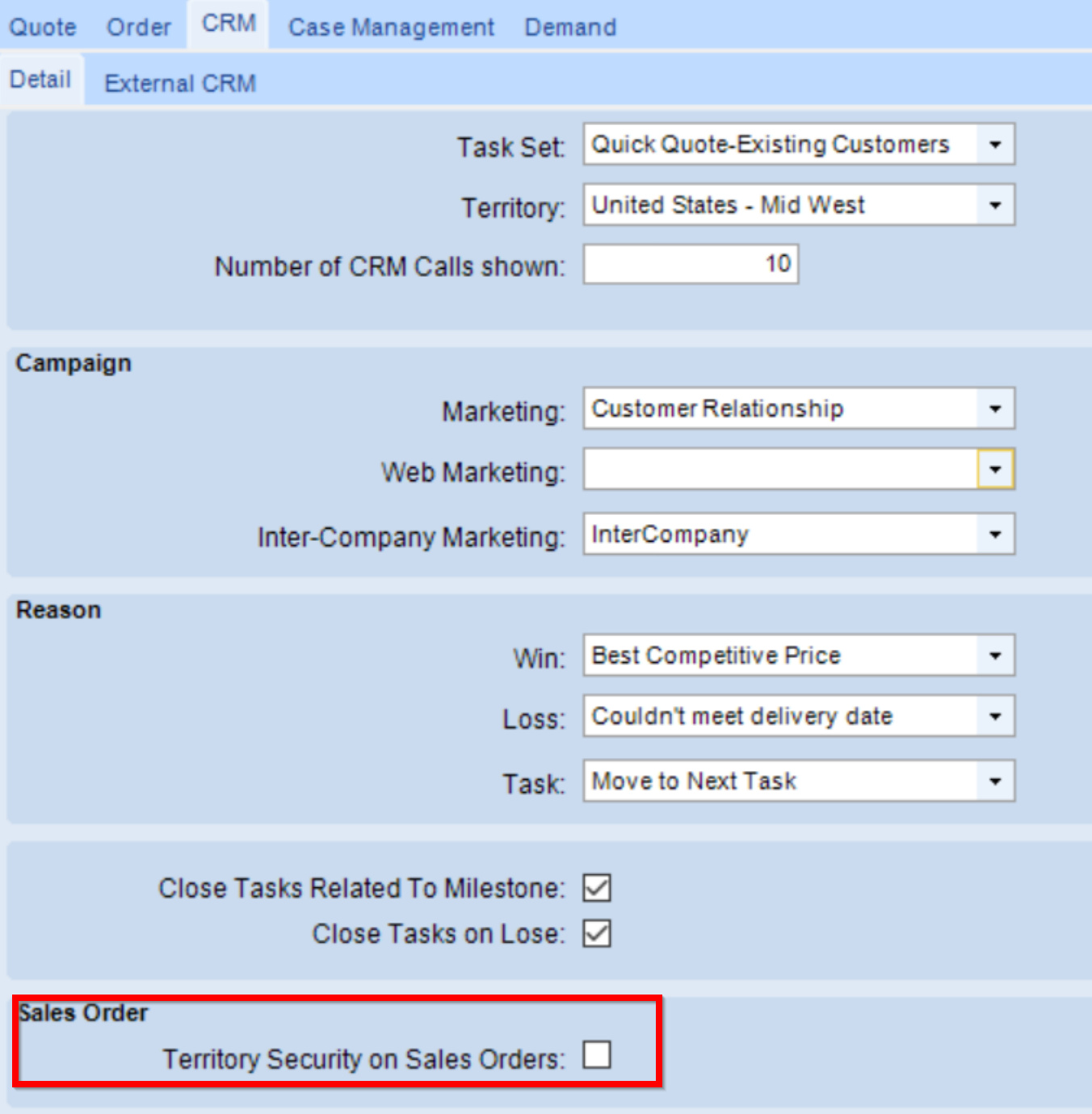

You mean like this :slight_smile:
We have that on but it doesn’t work. The reps using Mobile CRM can still see everything.
