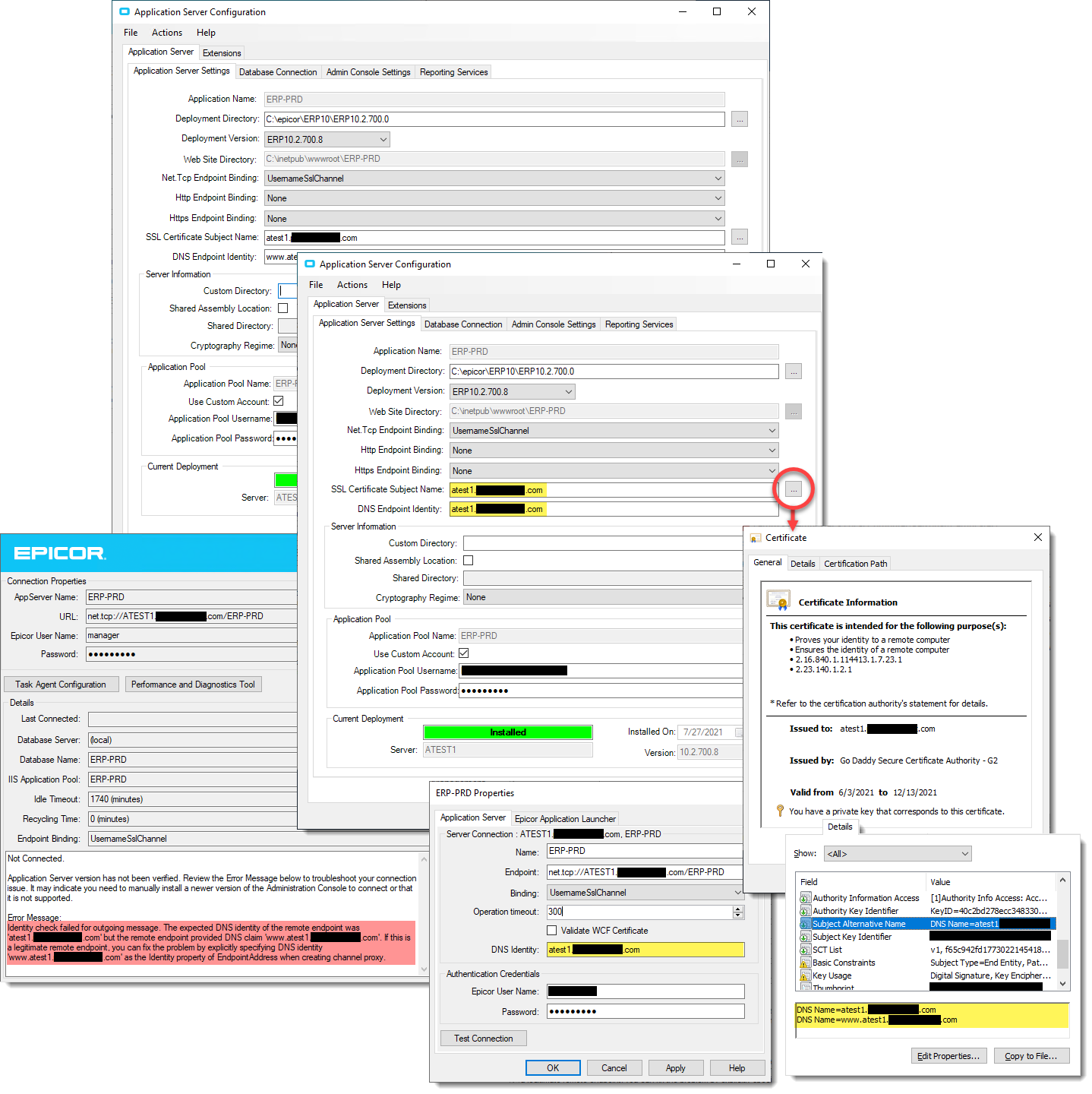

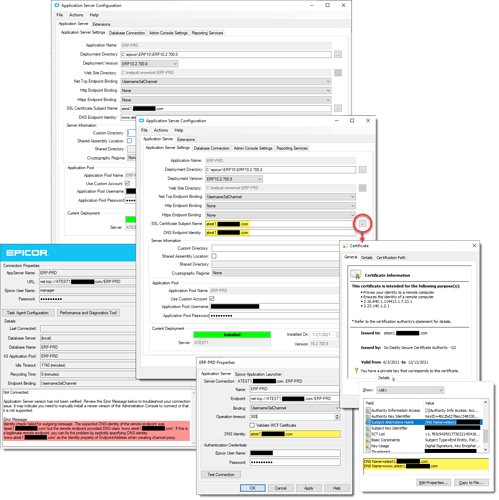

General Behavior:
Once the deployment finishes, the EAC automatically tries to connect to the newly deployed E10 server instance. When this happens, I receive a “DNS Endpoint Identity” error (see below, marked in red):
We are purposefully NOT configuring anything with the “www.” prefix in the DNS Endpoint reference. However, looking at the GoDaddy certificate’s SAN, it is listing two (2) SAN values – one of them with the “www.” prefix in front of it.
I’m not an SSL cert guru… but I am suspecting that Epicor is “choosing” the SAN with the prefix in front of it as a matter of “default interpretation”.
I do not know how to get Epicor to choose/select/use the other SAN value, presuming there is a way to do it. I acknowledge that this may be an IIS issue that needs to be resolved through some configuration setting in the “web.config” (perhaps), but I don’t have that level of understanding here.

in DNS indentity, write www.atest1… instead of atest1…

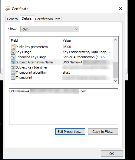

Does your GoDaddy certificate contain more than one Subject Alternative Name (SAN) value? If so, does either one of them have a “www.” in front of the SAN?
So, I did look into mine and it looks like my GoDaddy cert did not come with that alternate DNS, so it’s possible that that’s the root of the issue with your specific cert.
I have my Ops team generate the certs for me, so I’m not sure what’s involved, but is is possible to generate a new one that does not include the alternate?

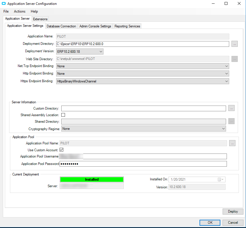

Additionally, I’m configured a bit different than yours. I see you’re still using net.tcp–is there a reason for that? I’m pretty sure that’s being depreciated in favor of HTTPS. You might try giving the HTTPS binding a go.

Thanks for providing the details of your specific configuration with the GoDaddy-issued cert. That helps me compare - and I agree… I believe the certificate containing two SAN values might be the issue, so we’ll likely see if we can get a different cert issued by them having only one SAN.
Certainly taking nothing away from @Olga’s suggestion - as she has previously made that suggestion in the other thread I created concerning this topic (which works, by the way). I was merely looking for further understanding related to why EAC was chirping about the DNS Endpoint Identity values, which I believe are causing additional problems for us in client-server interaction.
It was one of those situations where we change one DNS Identity value… oh, but look, more errors - and you need to change this other DNS Identity value… and, oh, but look, the client doesn’t work now, so you have to change this other value, etc.
Also - thank you for mentioning the possible issue with “Net.TCP”. I wasn’t even aware that it is being phased out - so, I’ll definitely look into the HTTPS configuration instead.

This looks like to be known issue in WCF - to check for last name in SAN:
https://social.msdn.microsoft.com/Forums/vstudio/en-US/03ce48bc-470c-4f24-ab40-0075d9d635f0/how-to-configure-san-certificate-with-different-host-name?forum=wcf
WCF is almost dead so I don’t think MS is going to do anything with it.

Looks like we may have to push back on GoDaddy to see if they can issue a new certificate that either [1] “flips” the two SAN values so that the one we’re trying to key on shows up last in the SAN list, [2] doesn’t contain the “www.” SAN value at all, or [3] is a “wildcard” certificate.
Or just use https :slight_smile:
… which I’m testing right now, actually, with good results.
I managed to get the “HttpsBinaryUsernameChannel” to work. EAC is connecting to the server application now - no chirping about DNS Identity value mismatches (because there is no DNS Identity setting to configure).
Then you’re ready for Kinetic too…
HttpsBinaryUsernameChannel is not using WCF SSL verification, IIS manages certificates for this case.
