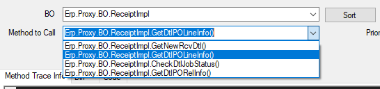

Yes this is what I got for the methods:

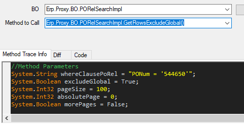

But I also gotta use this one to get the number of lines that the PO has. It’s all a big learning curve but with everyone’s help here and the already posted topics even though there is like 4 :frowning: are all helpful
If that is all done then how would you get the data out of responsedata since it returns a string? You would have to convert it no? I am trying to do something like this to add all the po lines:
dynamic searchPOS = EpicorRest.BoPost("Erp.BO.PORelSearchSvc", "GetRowsExcludeGlobal", new { whereClausePoRel = $"PONum = {po}", excludeGlobal = true, pageSize = 100, morePages = false, absolutePage = 0 }); ;

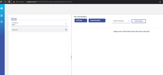

Maybe try:
  1. https://%servername%/%instance%/apps/resthelp/#/select-efx/v2//
  2. Checking/fixing the certificate error shown in your screenshot

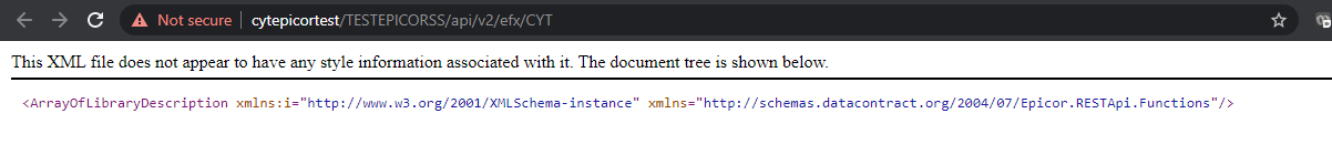

My functions are not showing up on that rest help link.
and here is the help page:
Did you authorize that function to that company? On the security tab of the function.
Yes I have it authorized in the security tab. I even just authed all companies and still doesn’t show up for any of them.
