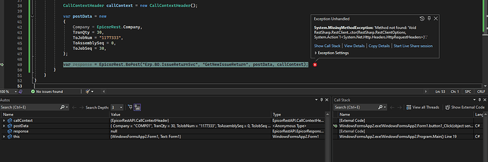

This is the code I have so far: -

        private void button1_Click(object sender, EventArgs e)
            EpicorRest.AppPoolHost = "*******";
            EpicorRest.AppPoolInstance = "KineticTest";
            EpicorRest.UserName = "******";
            EpicorRest.Password = "******";
            EpicorRest.APIKey = "************************************";
            EpicorRest.Company = "COMP01";
            EpicorRest.APIVersion = EpicorRestVersion.V1;
            EpicorRest.License = EpicorLicenseType.Default;
            EpicorRest.IgnoreCertErrors = true;
            CallContextHeader callContext = new CallContextHeader();
            var postData = new
                Company = EpicorRest.Company,
                TranQty = 30,
                ToJobNum = "1177333",
                ToAssemblySeq = 0,
                ToJobSeq = 30,
            var response = EpicorRest.BoPost("Erp.BO.IssueReturnSvc", "GetNewIssueReturn", postData, callContext);
When I run the debug I am getting the below
What version of .NET is your Project?

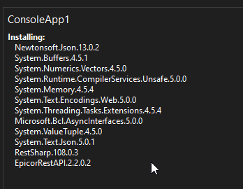

Make sure you install the RestSharp pre-reqs
REstSharp 108.0.3 and Newtonsoft 13.02
.Net is 4.8 for the project.
This is what i have installed: -

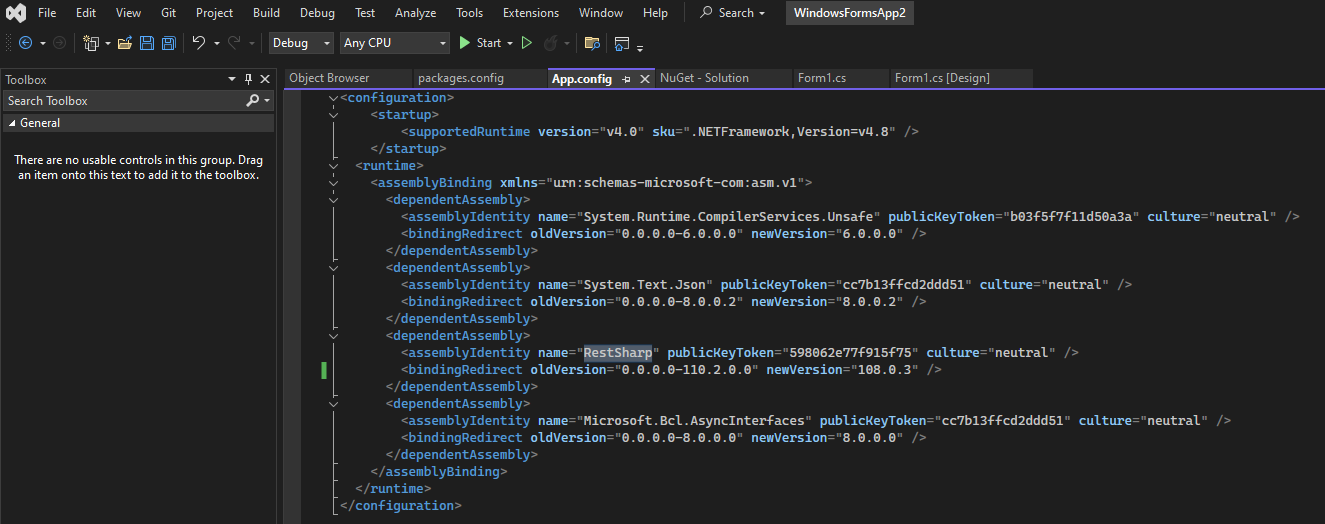

yes sharp is in the wrong version
Thanks, I have changed it now to 108.0.3, when I ran the Debug it still errored as was referencing 110 version still.
I manually changed the ‘new version’ show below
The program has now run and is not showing any errors but the material posting still didn’t happen, any ideas?
What response do you get? Your response object should have some properties indicating if the server said it was successful or returned an error.
Sorry Evan, where do I see that? There is nothing popping up with any messages.
