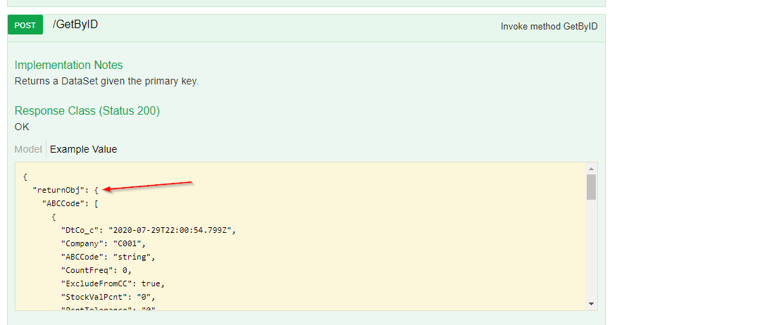

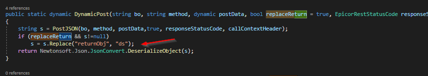

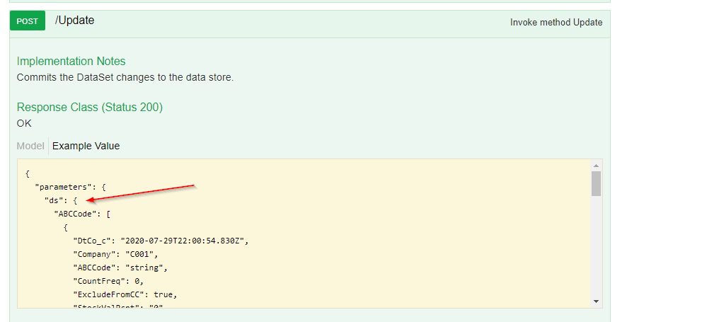

On the DynamicPost method, there is a parameter called ‘replaceReturn’ not mentioned above. Can you explain what that is?
thanks,
Yes some methods return a “returnObj” instead of a “ds” in JSON so if that flag is passed in as true I replace returnObj with ds in the JSON for you
Because most Post methods require a ds and not a returnObj
Which makes it easier to do a GetByID update the data and call Update without having to do a ton of Kung Fu

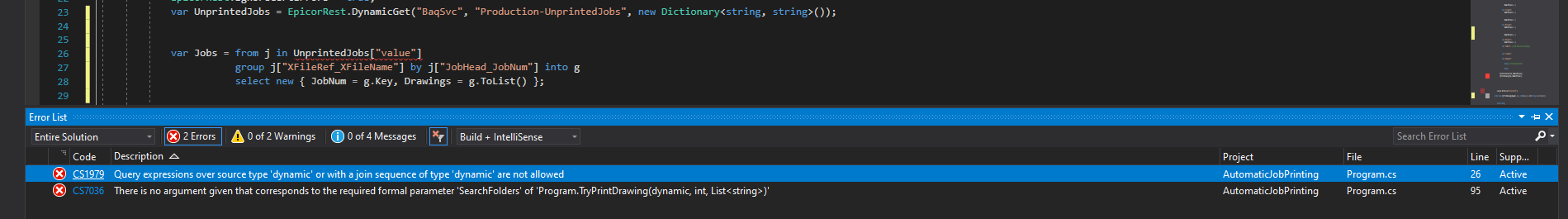

@josecgomez Is there a trick to being able to use LINQ on the results of a REST call? Just copy in into a standard collection first? Apparently Dynamic and LINQ do not get along…
You can do linq with dynamic like this
((IEnumerable<dynamic>)ds.ds.ShipTo).Cast<dynamic>().Where(l => l.ShipToNum == shipTo.ShipTo.ToString()).Any();
