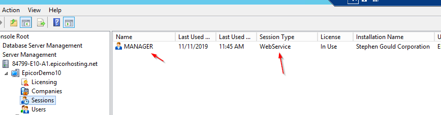

1. License Type
When setting up the Epicor Rest Helper you can now specify the license type you’d like to consumme
EpicorRest.AppPoolHost = "yourdomain.yourhosting.tld";
EpicorRest.AppPoolInstance = "EpicorDemo10";
EpicorRest.UserName = "manager";
EpicorRest.Password = "manager";
EpicorRest.IgnoreCertErrors = true;
EpicorRest.License = EpicorLicenseType.WebService; // You can now specify the license type, it default to "Default" if not specified

4. Session Info
Up until now REST Calls have not carried session specific headers now if you want to use an actual session (server side) you can do so, simply wrap any of the REST calls in an EpicorSession instance and the session information will be passed to the server with each call, and it will be disposed Logged out when the using finishes.
EpicorRest.CallSettings = new CallSettings("EPIC03", string.Empty, string.Empty, string.Empty);
//Note you must setup the Rest Helper FIRST before instantiating a new EpicorSession
using (EpicorSession sess = new EpicorSession())
     //The call below will carry a valid EpicorSession ID which can be monitored server side
     Dictionary<string, string> dic = new Dictionary<string, string>();
     dic.Add("$filter", $"Key1 eq 'Larry-Top' and Key5 eq 'Larry-Top'");
     dic.Add("$top", "1");
     newObj = EpicorRest.DynamicGet("Ice.BO.UD01Svc", "UD01s", dic, statusCode, c);
     //Session info can be accessed via EpicorRest.EpiSession
     Console.WriteLine(EpicorRest.EpiSession.SessionID);

@josecgomez … we’re not currently specifying any session data in our calls to the API. Are there any advantages to using that feature considering we are Epicor Cloud?
Hi @Jeff_Owens
That allows you to see server side the Session and address it , change it, etc using BPMs and such. It also gives you control of when the session is disposed etc can help with licensing
