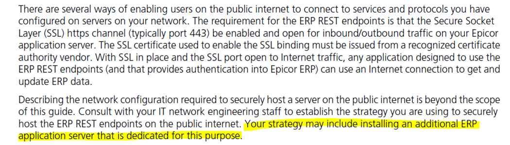

Epicor documentation contains the following:
There are several ways of enabling users on the public internet to connect to services and protocols you have
configured on servers on your network. The requirement for the ERP REST endpoints is that the Secure Socket
Layer (SSL) https channel (typically port 443) be enabled and open for inbound/outbound traffic on your Epicor
application server. The SSL certificate used to enable the SSL binding must be issued from a recognized certificate
authority vendor. With SSL in place and the SSL port open to Internet traffic, any application designed to use the
ERP REST endpoints (and that provides authentication into Epicor ERP) can use an Internet connection to get and
update ERP data.
Describing the network configuration required to securely host a server on the public internet is beyond the scope
of this guide. Consult with your IT network engineering staff to establish the strategy you are using to securely
host the ERP REST endpoints on the public internet. Your strategy may include installing an additional ERP
application server that is dedicated for this purpose.

Yes @dhewi,
I found what you post in the Epicor EVA installation guide
The only advice that many IT specialist emphasised on is do not open this port and/or allow these calls to point at your SQL server, i.e. if your IIS/ Epicor App server installed on the same SQL server as per Epicor recommendation for company below 50 users, then install an extra one in different location (server) and mount it to the SQL server, i.e. the servers you open port 443 to, should be away from your DB server and preferably on a server away from your day to day activities.

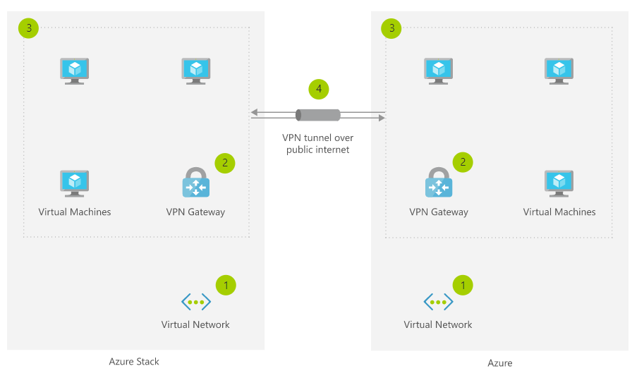

Hello Daryl,
You probably know what I’m going to propose but because our ERP10 is in Azure, it would make sense put the public portion of the interface you want to expose in Azure or SharePoint Online and let Microsoft handle the front-end issues for you. You can use Azure Active Directory to create accounts separate from your local AD. You would then create a gateway in Azure to your on-prem server and now your ERP system can listen on that one IP in Azure filtering out undesirable traffic.
This would also give you the added benefit of encapsulating your business logic from Epicor so if you were to buy a new company, upgrade versions, or switch even ERP vendors, you would just have to rewrite the code behind the interface to your customers/suppliers.
Mark W.
Interesting thoughts, and I have been looking, slightly naively at this point, at something along those lines. It’s a steep learning curve, but probably close to the definitive solution for the future. We are actively looking more at Azure, even though we have already concluded it isn’t the answer we need for Epicor directly at least for the next year or two, so hybrid solutions are looking increasingly attractive.
We’re still exploring right now, though, and the immediate need is only to expose dev to the outside world. So I think we’ll be able to be a bit simpler than this at first.
