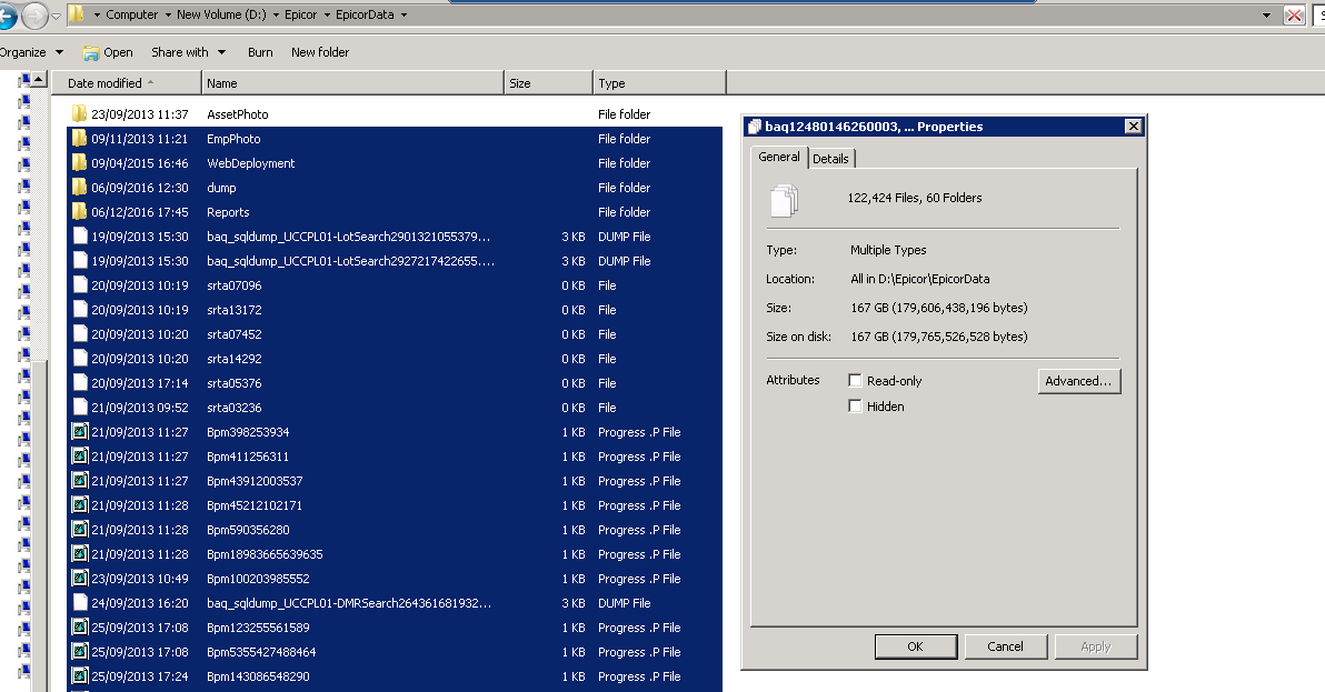

We have Epicor905 directory on D:\Epicor905 drive. I have checked the whole properties of complete drive. I found except epicor905 folder, epicor’s temp data is stored on EpicorData folder.(.p of all BAQs, and unknown files starting with 'db,srta,libi, dump folders) contain 167 GB of data. As your word file provided above ,the scripts deletes data more than 3 days. This 167 GB data i can see is older than 4 days from today 27th. Can i delete this data permenantly so i can free more space, ?

Check your mfgsys,pf config file for the -T parameter. That determines where those temporary .p files from baq execution and other temp files end up. From the graphic you sent it looks they are going to D:\Epicor\EpicorData. It would be cleaner to have them go to something like D:\Epicor\EpicorTemp so you could clean that directory with a script.
Yes @Jim_Lutz, I asked this bcoz if these files are not modified since 3 years or used by any program and in D:\ Epicor \ EpicorData folder,there are 4000+ .p files,whoes last modified date is 3 years ago. Actually we are on live 2 years back 2014 and these files are created on 2012/13(contains Training and pilot data).
