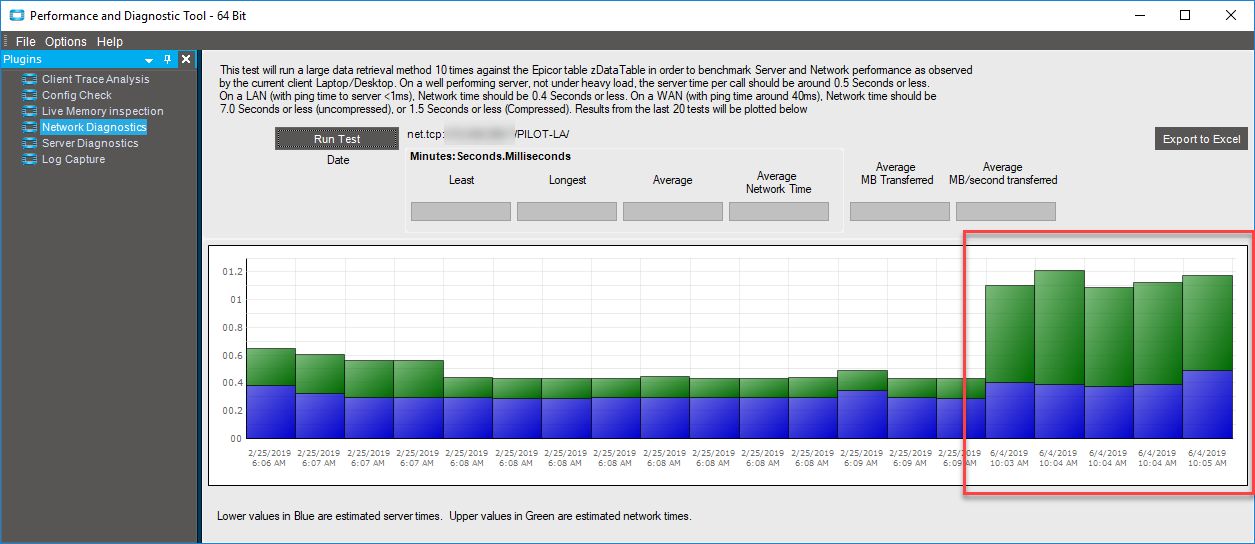

Here’s the PDT and Network test for Azure:
(The network tests were run from Mexico. They’re lower if I run this in Wisconsin)
