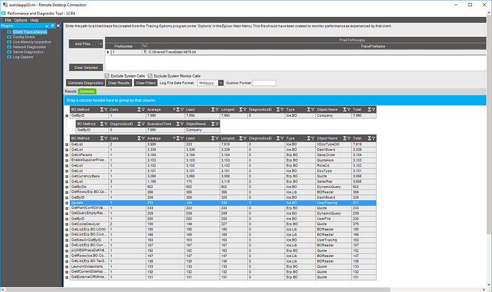

When in doubt tracing plus pdt are your friends
Well, that confirmed it’s slow, lol
Now what do I do with this data?
