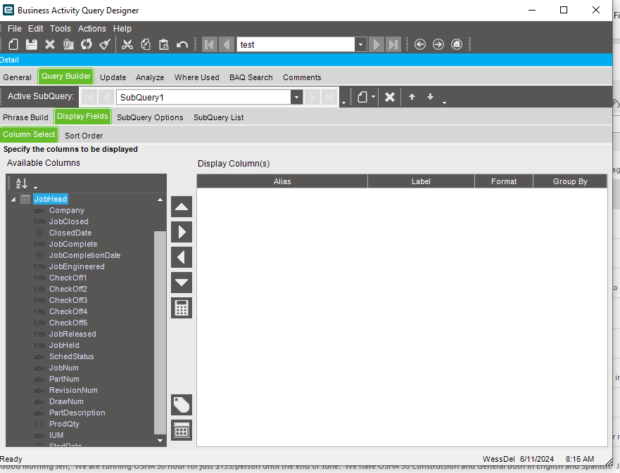

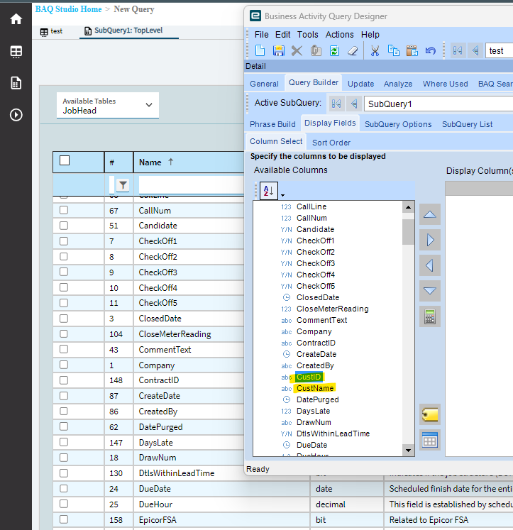

2024.1 on the left… 2023.2 on the right.
It appears to be gone from the designer – at least I can’t find it
When I removed the custID from my BAQ it started working again then when I went to try to add it back from the job_head it was gone from the list
It is gone from the table
