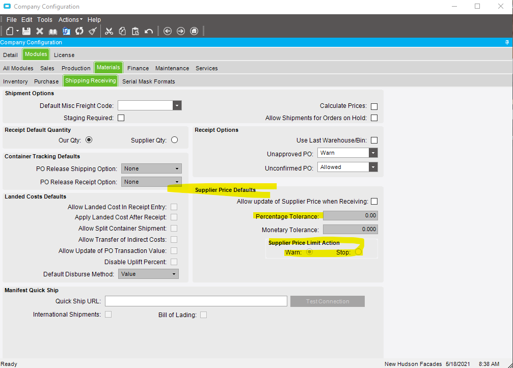

Nothing shows in the Modules -> Finance -> AP tab in the Company Config window.
There are 2 tolerance settings, but neither are for what you want.
