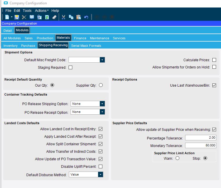

There is a company config setting to allow a receipt price update without backing out the receipt. I don’t think it updates the PO though.

Now with E10 stores can enter a price update on receipt (with a tolerance) and this will come through as PPV I believe.

Also, is there an area that we can attache receipt tolerances to, you know plus or minus 5% or something along those lines? I checked both supplier records and part record fields and cannot find what i am looking for.

As far as I know it is only the supplier price you can set a tolerance on in the company config.
That is what I was afraid of. Thanks for the reply.
