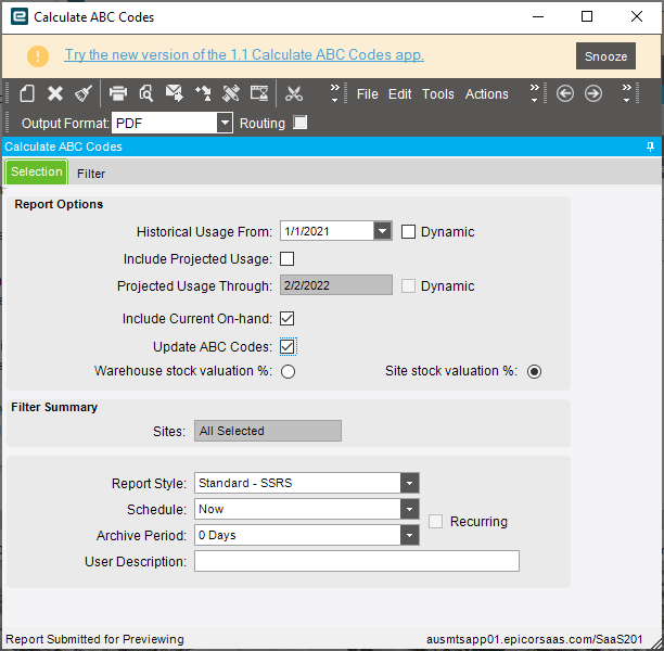

I just found an interesting glitch on a multi-tenant customer.
We have set up ABC codes as follows
When I ran calculate ABC codes and used the PDF format
It took all of the parts that had no usage or inventory and made them “X”
when I ran calculate ABC and used the CSV or ExcelData only, it did not assign the “X” code.
Big difference because there were 20,000 parts out of 27,000 that we didn’t want to cycle count.

Hi Bruce. Any update on this issue? I have a similar one in 10.2. I have the same ABC definition you have and when I run the Calculate ABC, all parts that should be X are C, only for one plant, whatever the report format I select. There is no site/warehouse ABC config.
the way that ABC Code is calculated, if your C has 100%, then the balance of all the parts that are not A or B already will become C items.
