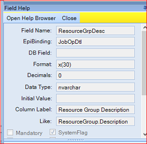

I don’t see it in the database, but if I use field help I see a field called ResourceGrpDesc
