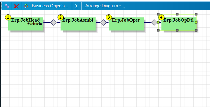

I am working on a dashboard that will allow a user to change the Resource Group tied to an Operation, but I am getting a null object error along the way.
My first shot was to use the UBAQ functionality to do everything:
After updating the ResourceGrpID field in the JobOpDtl Table, I got the following error:
I also tried to tackle this by code, and am getting the same error:
