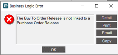

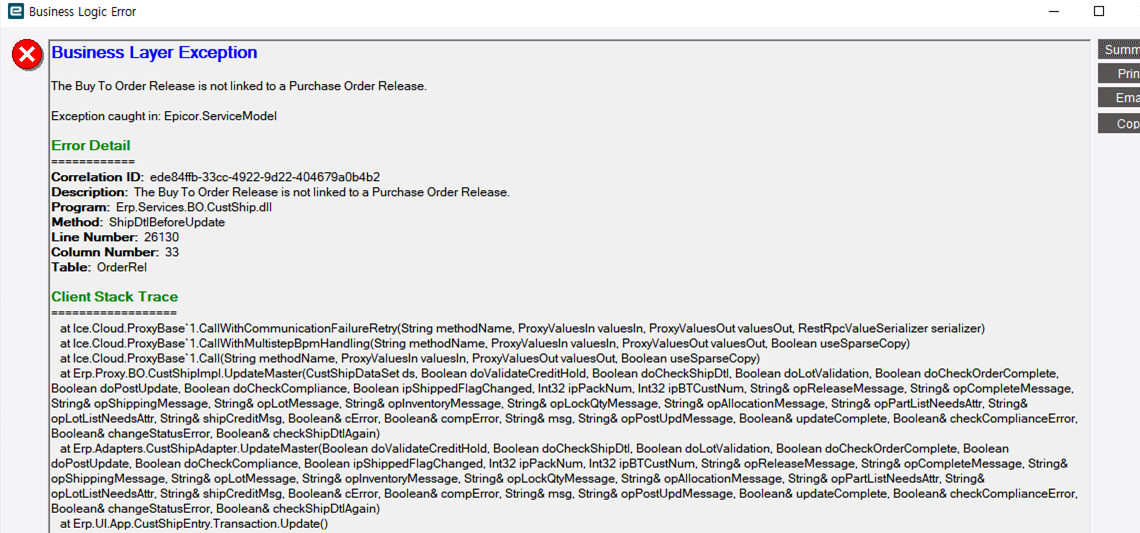

Hello everyone,
When I create a line in Customer shipment Entry, the following error message pops up.
What’s this problem? How do i correct?

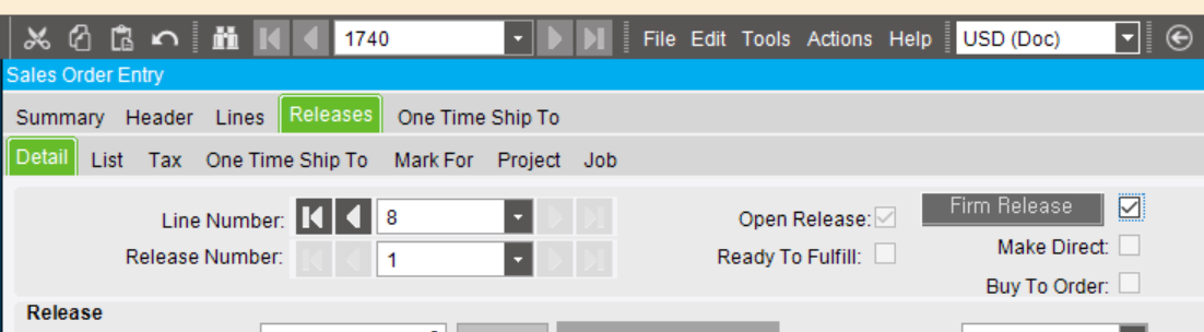

This button is disabled. What should I do?

One peculiar thing is that other lines that work well have “Make Direct” and “Buy To Order” enabled, but this line has them disabled.

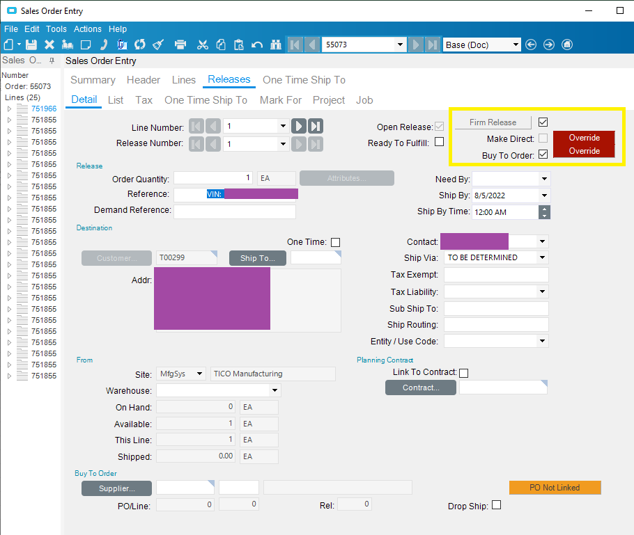

What happens to me every so often is:
  • This line/release has a make-to-order job tied to it
  • Someone changed the part number on the line
    • (at 3:11 PM, according to change log)
  • The new part was not an existing part in Epicor (it’s a part on the fly)
  • Per our company setting, a part on the fly on a sales order is set to “buy to order” on the release
  • Now, after the part was put on the order, the part is set up in Epicor as a non-stock and manufactured part
    • (at 3:13 PM)
  • Order screen looks like first pic below, with “buy to order” checked (I don’t want that)

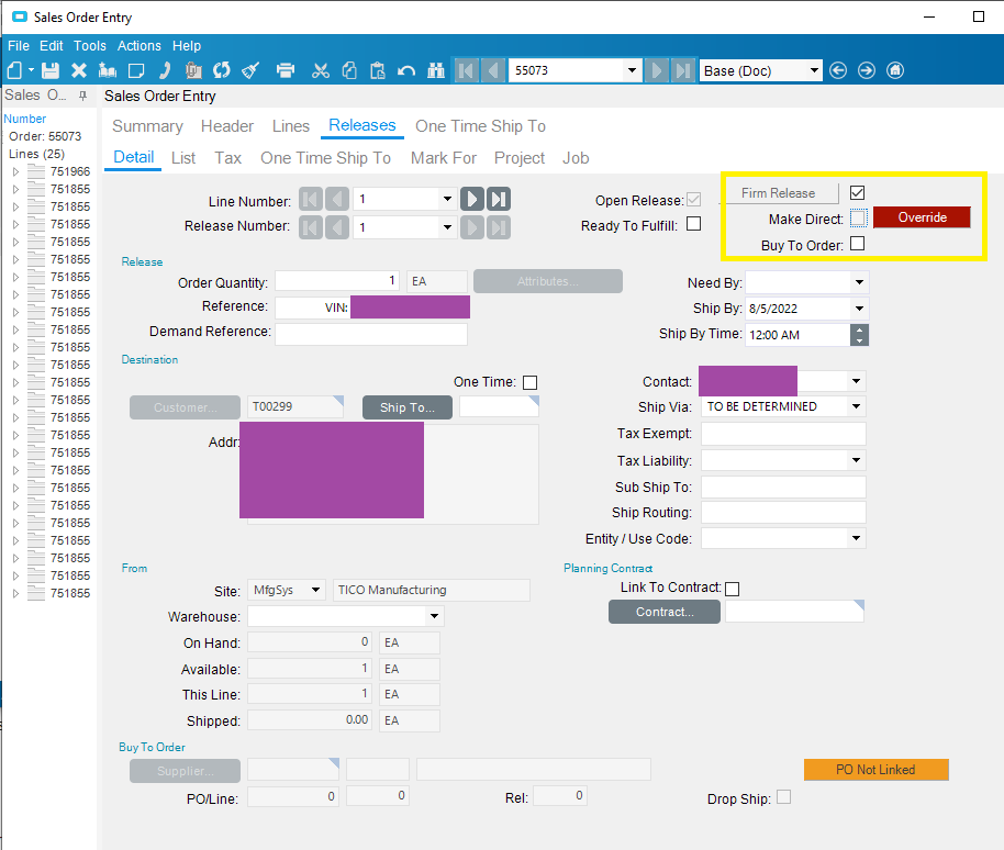

  • If I try to change it, I can’t (second pic below). It lets me uncheck BTO but “Make Direct” is grayed out.
And the only way I can fix this is to DMT the right settings.
But at least I actually see “buy to order” checked. You don’t, so that’s odd.
Also, MRP has not run since the problem began. If it had, I’d have a PO suggestion and I’d have to delete that first.
Problem
After trying to fix (no use)
DMT:
And now it’s right
