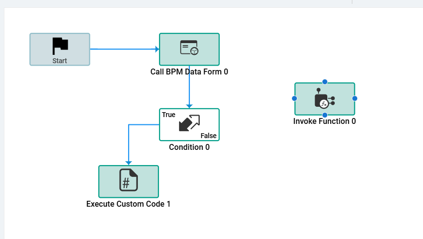

The BPM is on ARInvoice.DeleteMaster (pre-proc). It opens a DataForm to ask the user why they’re deleting an invoice. Then it takes some details from InvcHead and Invokes a Function that logs everything to a UD Table.

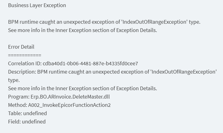

When I built this late last year, it worked perfectly. At some point recently (not sure exactly when), it starting throwing an error.
The function actually still executes, but DeleteMaster fails and the Invoice is not deleted.
I couldn’t find anywhere I actually used indexing, and the whole function is wrapped in try/catch.
I added some debug messages before the Invoke Function widget, but the error came up without throwing any of the debug messages. Since I didn’t know where to start debugging, I replaced the “Invoke Function” widget and invoked the function via a custom code block (code below). All the parameters are the same variables / expressions as I configured in the Invoke Function widget. I figured I might be able to get more detail on the error if I put try / catch around the actual function call.
When I did this, the error went away. It never got to the catch block. It worked exactly as expected. Why would an Invoke Function widget work differently than this.InvokeFunction()?

Is it possible the signature of the function changed since you first created the widget? The widgets don’t update themselves have to delete and recreate. Just the first scenario that comes to mind.
Just tried deleting the widget and creating a new widget with new configuration. Same result. Good thought, though. I originally double-checked that the configured params matched the function params, but didn’t delete or reconfigure. The one thing I tried changing was switching the “DeletingUser” param from Session.UserID to callContextClient.CurrentUserID, but that had no effect.

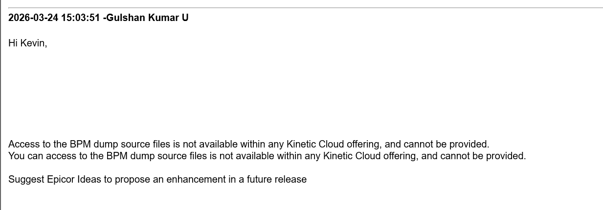

Response from Epicor:
“Cannot be provided”
BS, change one line in host.config to put them in the EpicorData directory.
It’s just laziness. Make it the default.
