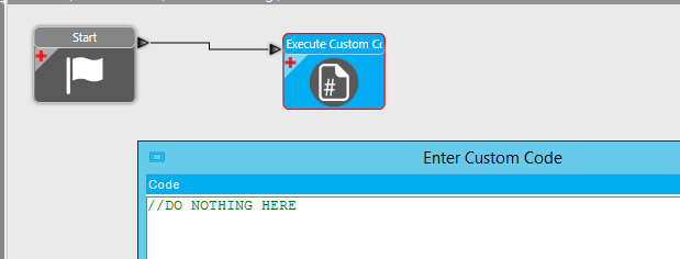

The BPM code is in the GetList.Post process in the UBAQ code. if I turn off the BPM, then the error doesn’t get thrown… Here is the error:
Any clues… we even commented out all the code in the BPM, and it still throws the same error.
