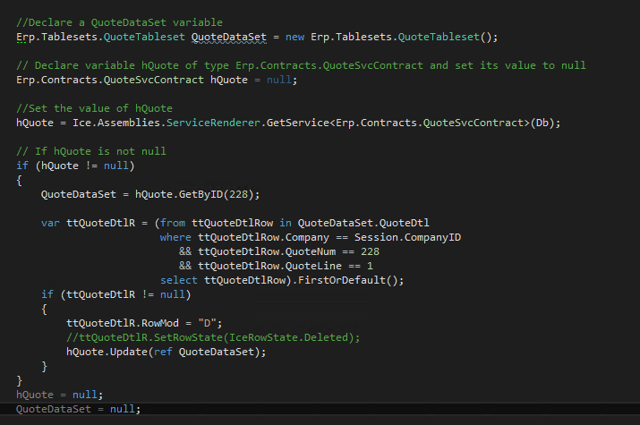

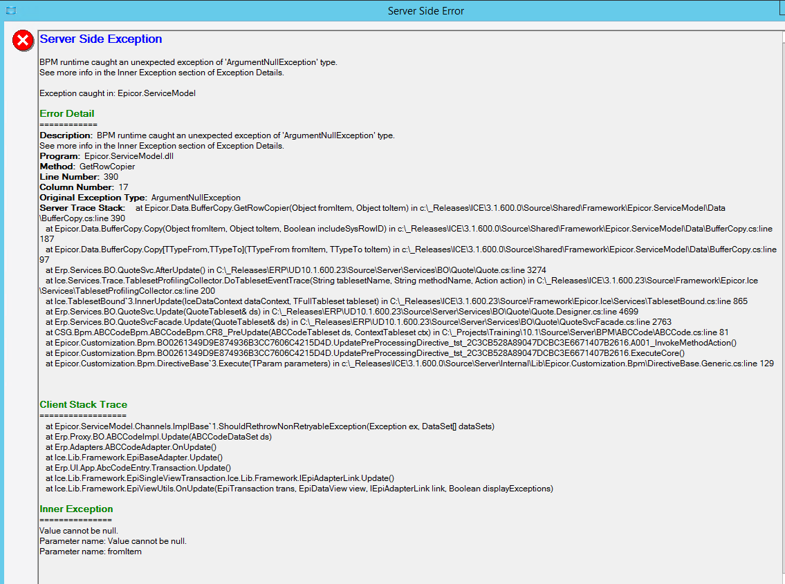

Hello guys, I created a code to delete a Quote Line by a BPM but got the below error, has anyone had this error before?
You have to select linked table as well.
QuoteDtl, QuoteCoPart, QuoteQty, Qtmmkup

Awesome thanks a lot @surendrapal it worked!
