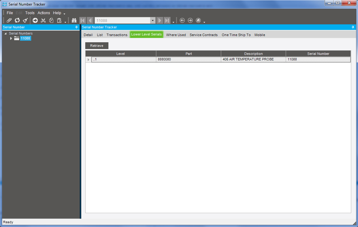

Yes, we’re using Serial Number Assignment for this. The few jobs I’ve checked so far don’t have additional lower-level serial numbers. They look like this in the SN Tracker:

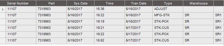

I noticed something in the Tracker’s Transactions tab-- for a job that has three serial numbers (but the error says 4 are assigned), two serial numbers have STK-PCK and STK-CUS transactions. The Third serial, however, does not. Does this indicate something?
Serial WITH STK-CUS transactions:
Serial WITHOUT STK-CUS transactions:

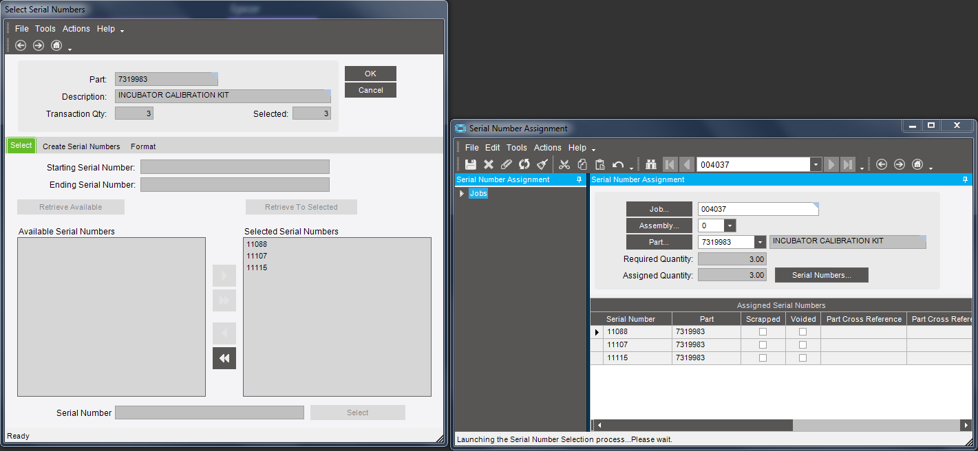

Can you post a picture of the Serial Number assignment window?
Here’s the Serial Number Assignment window for one of the anomalous jobs.
In the Job tracker screen under the Serial numbers tab you don’t have 4 serial numbers?
Nope, in the job tracker screen (and everywhere else) we’re only seeing the correct number of serial numbers.

Tech support theorized that when the serial number was assigned to the job a second time, equaling the “4 assigned,” when its status was changed to ADJUST while the job was still open. In their words:
"Luke,
I see that SN 11088 has an additional ADJUST transaction at 16:29. In my own experience I have noticed that at times when there is an ADJUST transaction on a SN it ‘re assigns’ to the job if it has not been closed. We would need to determine first how that ADJUST transaction came in in the first place. We have 2 fixes for this scenario, one would be the generic job closing fix and the other one is to remove that ADJUST transaction which is specific for that one record. Let me know your thoughts on this. "
I checked the problematic jobs in our database and sure enough, each of them have at least one serial with a transaction history that abruptly ends in an ADJUST transaction.
Yah, looks like for the job I’m looking at they did an adjust out of inventory on the part/serial number (product was to be used as a showpiece or something) and did this before closing the job. Thus, same thing - there is an ADJUST transaction on the serial number.

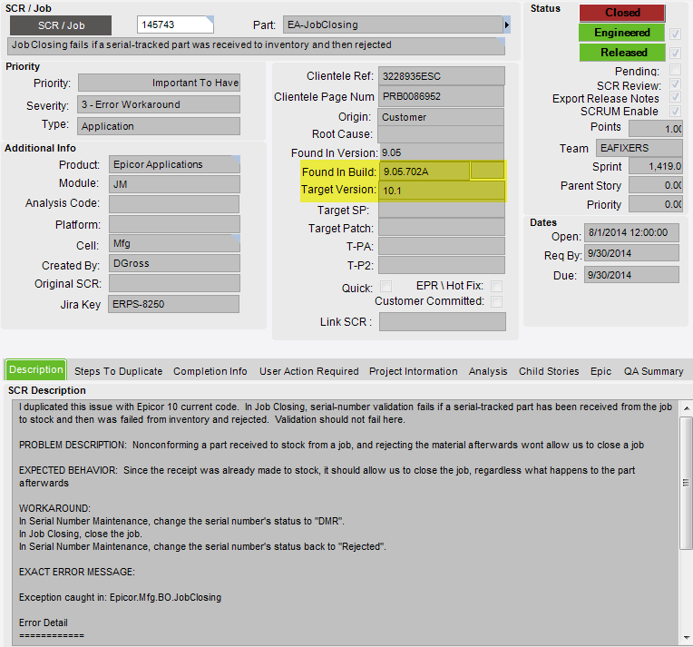

Many years later, and this issue is still lingering. it is already V10.2.5.
