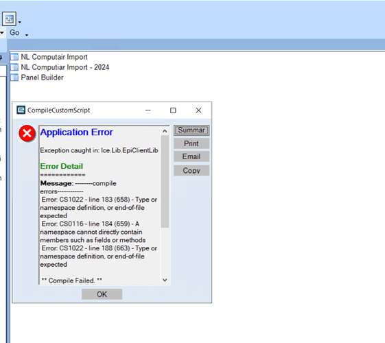

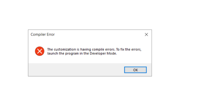

Hey @josecgomez , I have an issue. When I tried to add an event handler for the onclick event for a button I added for testing, I got an error after closing the editor and trying to open it again. Could you give me a hint on how to fix it back
Screenshot 2024-06-14 143207
You can use Customization Maintenance to pull it up and fix the code.
Show the code, something is not in the right place, missing a semicolon etc.

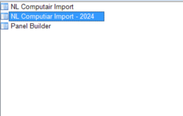

I fixed it by copying the code back through maintenance. May I ask, how do we create a new one from scratch? Maybe I can use it for testing instead of having to modify the one that is currently in use. For example, how can I add a new one below these?
