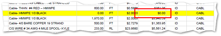

I have a BAQ report that runs fine in when PDF is the output format, but creates an “error” in the excel file when Excel is the format selected.
The “error” is that a field that calculates to zero, is being displayed as text, with a value 0.000000000000000000.
PDF Output is what is expected:
(the report highlights the line. The red box is the field in question)
The Excel format introduces an error
the expression of that field is:
=Microsoft.VisualBasic.Interaction.iif(Fields!Part_CostMethod.Value = "A", fields!Calculated_Avg_Total.Value, Microsoft.VisualBasic.Interaction.iif(Fields!Part_CostMethod.Value = "S", Fields!Calculated_Std_Total.Value, Fields!Calculated_Last_Total.Value)) * Fields!PartBin_OnhandQty.Value
