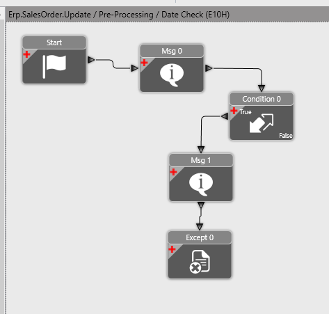

While testing a BPM, I added a Show Message Widget to show me some debugging info.
But the message never shows when an Exception widget is reached later in the execution path.
If the condition block results in true, then ONLY the exception message (2) shows.
If the Exception block results in false, then ONLY the Show Message (1) shows.
I’d expect the Show message (1) to show every time.

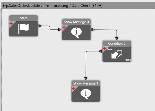

Changing the exception to a second Show Message, and it preforms as expected.
First message always shows. Second message only when condition is true.
Is this normal?
Adding another Show Message between the Condition and the Exception, like:
Still only shows the exception message.
It’s like the compiler optimizes out the show Messages, when it is going to result in an exception.
If I had other widgets in there, like Invoke BO, or send email, prior to the exception, would they be skipped too?

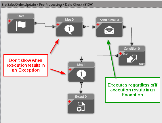

Edit
An email widget placed before the condition, always executes.
But the show messages don’t when the execution results in the exception.
It is my understanding that the messages are merely queued and delivered after execution is done. So when you see 10 message-boxes in a row, the code already is done executing, you are not stopping execution.
Thats why I never use MessageBoxes to debug but instead
Ice.Diagnostics.Log.WriteEntry("");
Yes because the exception is rolling back everything that is queued up to fire otherwise. Remember that the sequence of events is fixed and it doesn’t ping pong back and forth between UI and back end. BPM forms are the only exception, but when you review the BPM sources they have special conditions for handling that interruption.
Also a Messagebox in PRE could be stopped by POST. I think it waits until the entire BPM is done completing before they are delivered to the UI.
Not exactly. The email widget still executed.
Sure but that’s not UI dependent now is it lol. Everything happens sequentially back on the server but it only “reports back” to the UI once.
So if you look at the BPM Code the Email is sent during execution…

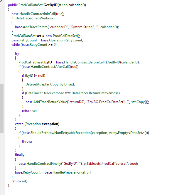

The MessageBox is Published to the stack… actually if you do it through Reflection it is added to the Context and the client probably reads the callContext and says “Oh I got stuff to show”.
protected void PublishInfoMessage(
	string message,
	BusinessObjectMessageType severity,
	InfoMessageDisplayMode displayMode,
	string bo,
	string method)
	this.BpmContext.InfoMessages.Add(
		new InfoMessageRow {
			MessageText = message,
			Severity = (int)severity,
			DisplayMode = (int)displayMode,
			Company = this.Session.CompanyID,
			UserIdent = this.Session.UserID,
			Plant = this.Session.PlantID,
			BO = bo,
			Method = method

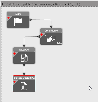

Would code in the Exec Custom Code widget shown below actually be executed?
It wont… if you do the exception that way, it does a throw (immediate). The other way you can do exceptions via code is AddBLException which adds it to a stack to be shown at end – but the widget does a throw.

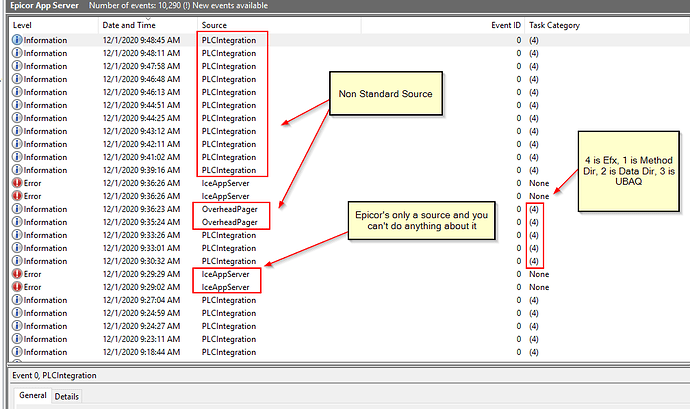

But plan to switch to traces, because apparently WriteEntry is also flooding my Event Log in Windows! Argh. But it does show up in ServerLog
The other issue with WriteEntry using Ice is you can’t categorize. We wrote a dll aptly named “BetterLog” that uses the System logging methods, it makes the event viewer palatable
