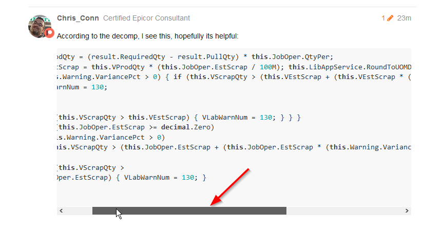

According to the decomp, I see this, hopefully its helpful:
this.VProdQty = (result.RequiredQty - result.PullQty) * this.JobOper.QtyPer;
this.VEstScrap = this.VProdQty * (this.JobOper.EstScrap / 100M); this.LibAppService.RoundToUOMDec(this.JobOper.IUM, ref this.VEstScrap);
 if (this.Warning.VariancePct > 0) { if (this.VScrapQty > (this.VEstScrap + (this.VEstScrap * (this.Warning.VariancePct / 100M))))
 { VLabWarnNum = 130;
else if (this.VScrapQty > this.VEstScrap) { VLabWarnNum = 130; } } }

some of the text is cut off on the right side (of above code) - How do you get this?
There is a scroll bar. Is that what you are looking for?

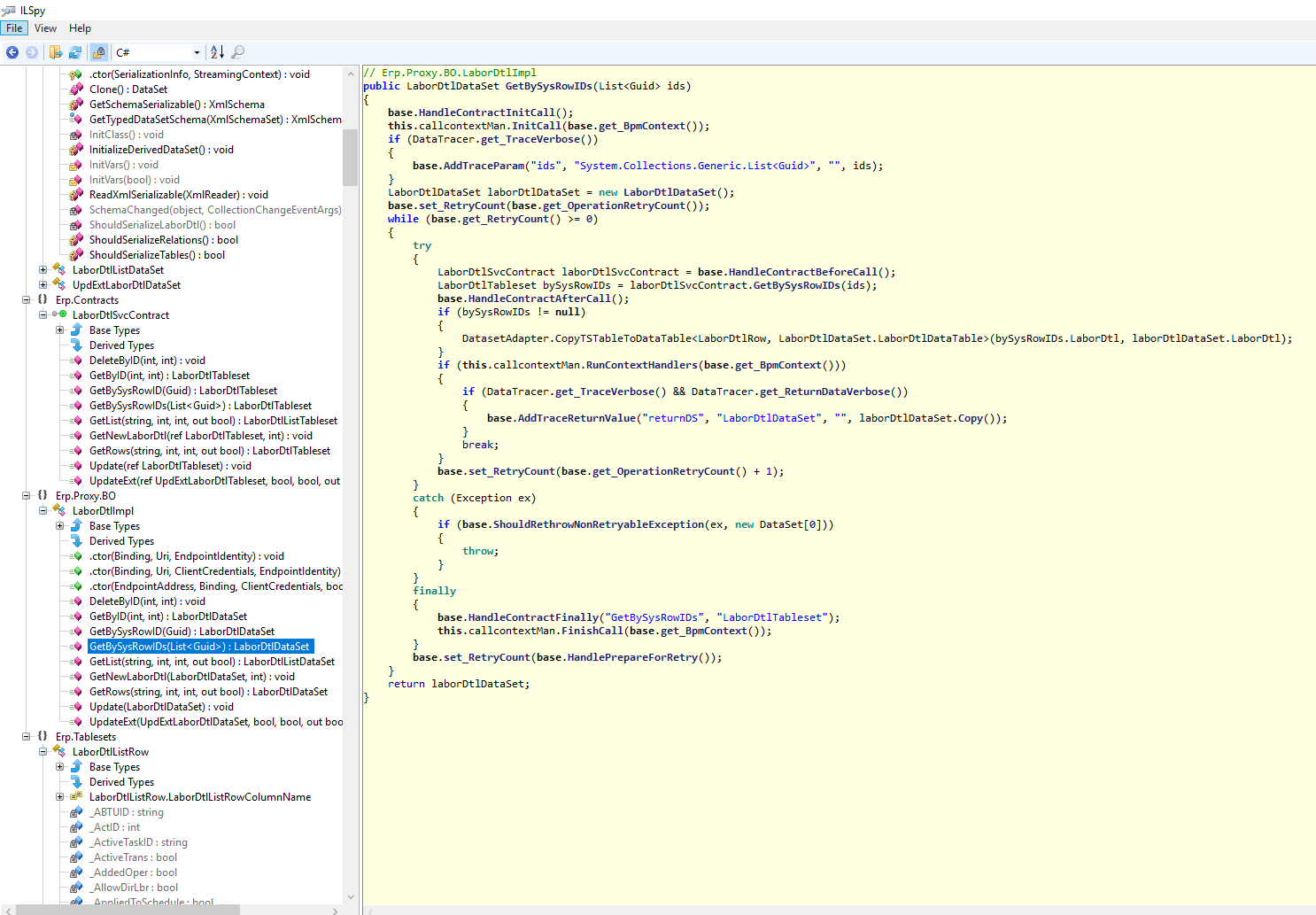

Very useful piece of info Chris, could you please shed some light on where to find such codes, i.e. is there a way of finding Epicor BASE BPM/FORM RUN C# Codes?
Hi @A.Baeisa,
Use something like Reflector, ILSpy or similar to decompile the DLLs. It’s not as easy as it sounds sometimes because as you know, Epicor is a massive program built from many libraries. It turns into a bit of an investigation sometimes to find what I am looking for, but usually the ends justify the means and what I find is helpful in letting me understand why the program is doing what it is doing.
To find base processing you should probably look at the server dll’s of the relevant BO.

many thanks Chris, really appreciate that, i have been told that we need to pay ÂŁ50,000 to get Epicor source codes, so i have download .Net Reflector (14 days trail), and found many DLL files on the server related to BO under different category, Adaptor, Contracts, Triggers, and Services, but could not generate the decompiled files, have you got a link to explain this process step by step.
it is working now,:slight_smile:, many thanks Chris
So the source codes (SDK) have their own merit. You can see the actual code and comments from developers. While the decompiling works well enough, sometime the logic can be obscured a little bit, Despite this, 9 out 10 times, you gain enough information to solve you problems.
ILSpy free and working great, just want to learn from your experience, what dll table did you decompile on this case, where did you find the code you posted?
It was a server assembly called internal.lib.warndef or similar
