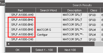

Here’s the default Part Search window. I have to widen the column to see which of these Is the one I want.
And here’s the Part Transaction History Tracker. It only shows the first 13 characters.
The full P/N is SPLF-A1000-BH020-020K
(I never bothered making a customization to make the field wider)
