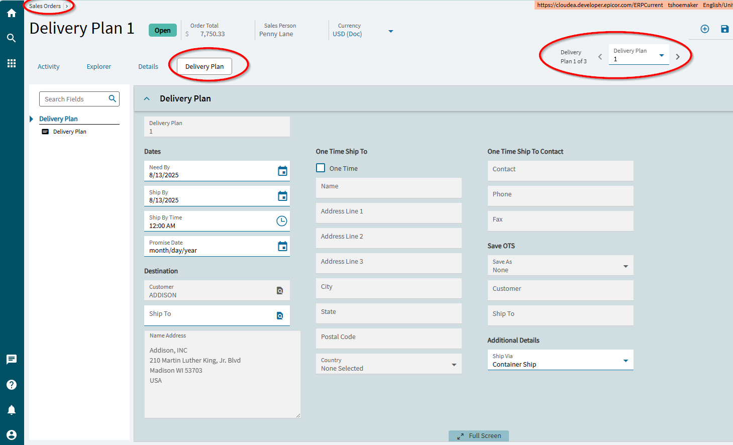

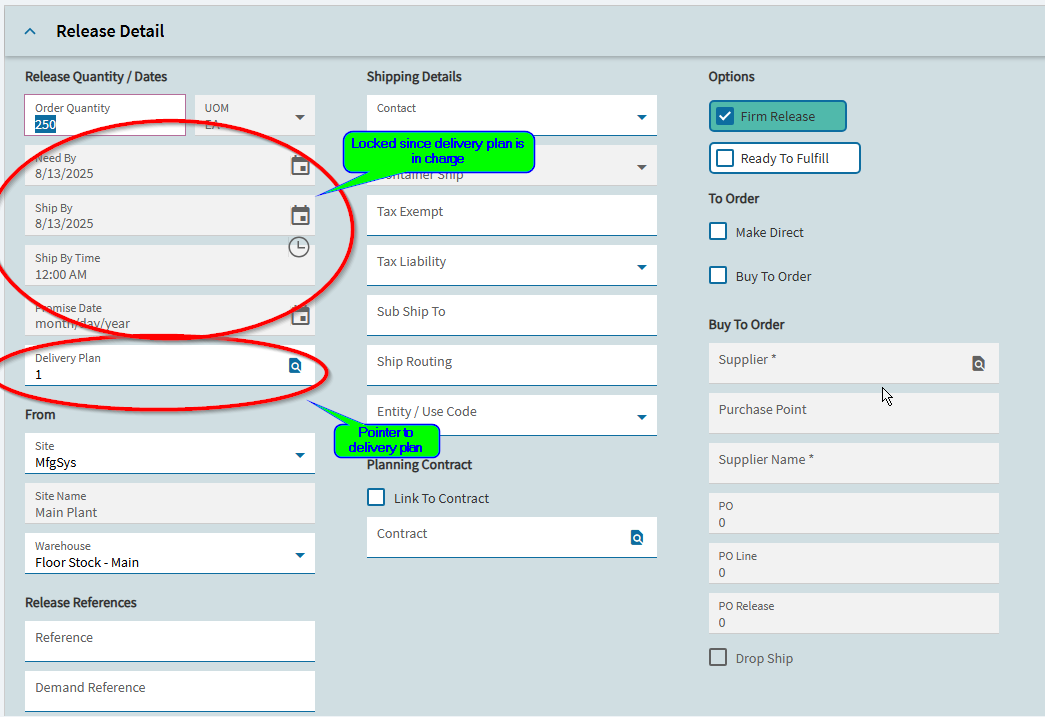

with idea https://epicor.ideas.aha.io/ideas/KIN-I-5791 we added an optional feature to create a delivery plan where ll delivery related items are included on the delivery plan. (see image 1 below). Then when you are adding lines or releases, you can point the release at a delivery plan number, and all the info from the delivery are populated to the release. THEN LATER, if you ever change the delivery plan, the data is pushed to all attached releases.
Image 1: the Delivery plan screen:
Image 2: where you associate a release to a delivery plan… note how the dates are disabled. This is becuase the delivery plan is in charge of these dates now.
is Delivery Plan 1 unique to that Order?
so on another order delivery plan 1 could be different dates?
I’m trying to think of the main use case(s) for Delivery Plan, and all that comes to mind is keeping multiple SO lines, each with multiple SO releases, synchronized with each other. E.g., so that Widget1, Widget2, and Widget3 on the same SO all deliver together consistently on the same schedule, and if the schedule changes, then a single update to the Delivery plan will affect all 3 lines at once.
Delivery plan is per order.. you can specify as many deliveries as you want on the order, but each delivery plan is specific to that order (no shared delivery plans between orders).
Tim, that is one case… but there are companies who sell sets of things that all must be delivered on different days…
Scenario 1: lets say that you have an order with five widges… the customer wants to have monthly deliveries of those widgets at 100 per month for the next 12 months (ok.. just doing the simple math: 5 lines times 12 deliveries = 60 separate releases). In this example, you would create the delivery schedule for the 12 deliveries… then you would create the lines, and while creating the releases, you would assign each release to one of the deliveries. NOW when the customer asks for delivery 3 to be rescheduled, you simply change the one “delivery 3” to a new date, and all 12 releases are updated.
Scenario 2: you are a sign manufacturer, and you have an order for 5 different signs to be delivered to 50 different locations (20*50 = 1000 sales order releases). each location has varying delivery date. You would define the delivery plan (the 50 locations and dates) and then create the 20 lines, and add the 50 releases for each. Tomorrow the customer calls and asks for the St Louis address to change to a new location and date. They also revise the date on 4 other deliveries. Before you would have to look through all 20 lines to find the appropriate releases to fix. Now you just need to go to the affected deliveries and the system will update the lines/releases.
Note that this is NOT a feature for everyone, but it will help out those customers who have large linked orders with multiple deliveries and items.
