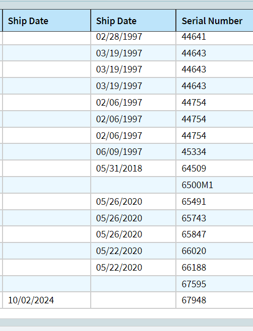

So I can have the below highighted field
Show data from either column depending on where the data is? Like serial 67948 would show 10/02/2024 and 66188 would show 05/22/2020
Or are you saying I need to copy the data in field 10/02/2024 into the column with all the other ship dates?

In a BAQ, yes.

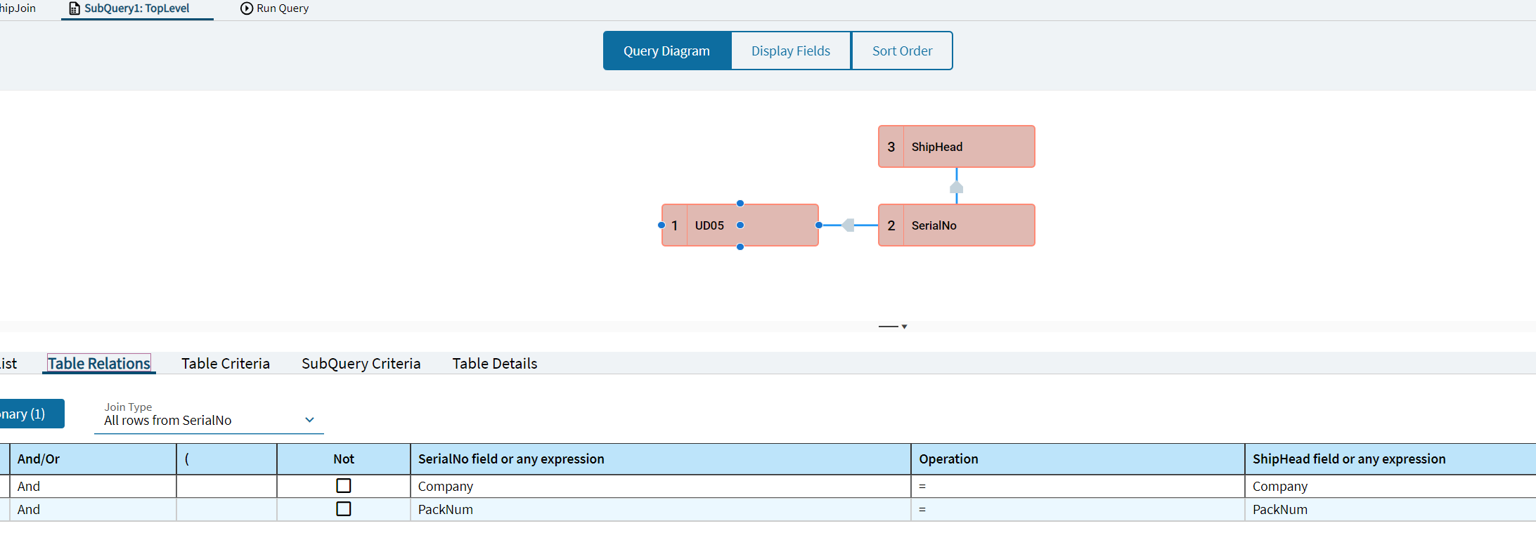

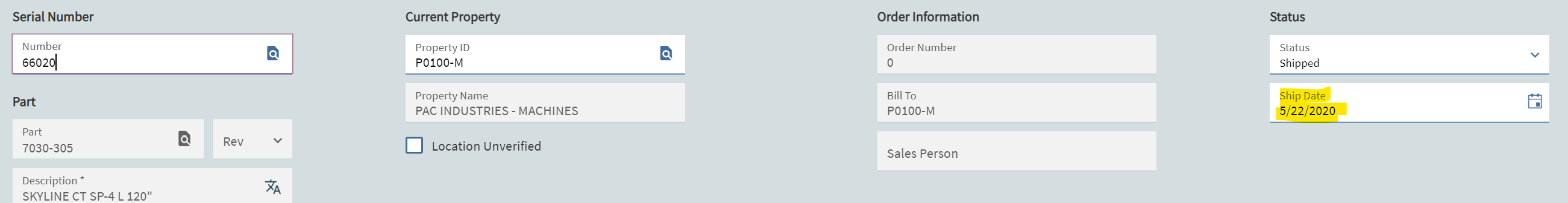

Yes, the first image is a version of the serial number tracker dashboard that I changed to reflect what we need to show.
The second is a BAQ I created to show where the data is stored.
If I am understanding your BAQ and the data you are trying to display, my approach would be to create a calculated field using conditions that will use the appropriate Ship Date value. If needed, this logic can be expanded to additional fields.

You can just use a union to merge the two sets of data.
