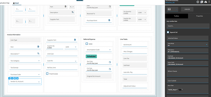

Hello Guys,
i added a combobox in ap invoice entry.
and try to filter by Vendor ID.
it doesn’t work.
i tried a lot of combination.
UD10_key1=??‘{VendorID}’
UD10_Key1 =?‘{VendorID}’
all of them not working.
can you please help what is the syntax to add the filter.
thanks,
Eddy

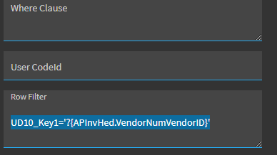

I think question mark goes inside the single quotes.
UD10_Key1 ='?{VendorID}'
tried and not working.
it return empty. it should return one record.
Try moving that down to the Search Filter instead of the Row Filter… I saw that work for someone else on here… can’t find the post now, to link it.
