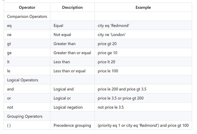

If you’re using OData they use a type of syntax
eq
: Tests whether a field is equal to a constant value.ne
: Tests whether a field is not equal to a constant value.gt
: Tests whether a field is greater than a constant value.lt
: Tests whether a field is less than a constant value.ge
: Tests whether a field is greater than or equal to a constant value.le
: Tests whether a field is less than or equal to a constant value.OData comparison operator reference - Azure AI Search | Microsoft Learn
So in the filter box it would something like
SellingQuantity
gt
0
- > This would be SellingQuantity greater than 0
That was the missing link. Thank you @aarong .
For my example, it’s PartPlant_PersonID eq ‘SOMEBODY’
I did that in Swagger just like I have it above and it worked. But I see the URL shows the spaces converted to %20 and the dollar sign was converted to %24. I’ll have to play with that in the get request and make sure that formats properly.
Swagger uses a URLEncode library.
If you’re writing external code, you can wrap it in a library… Take a look on npm there is multiple.
