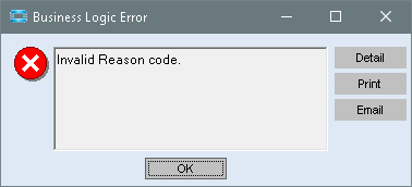

It does work in Qty Adj form - And by work mean that manually typing a Reason’s Code or Description into the combo, fails to process. Showing the above mentioned “Invalid Reason Code” message.

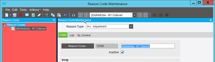

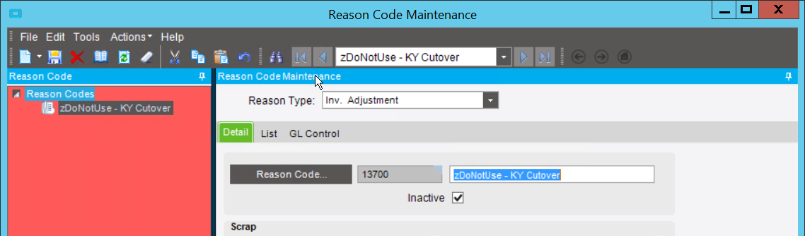

  1. Create custom checkbox field: Reason.Inactive_c
  2. Create customization to add Inactive checkbox to Reason Code Maintenance

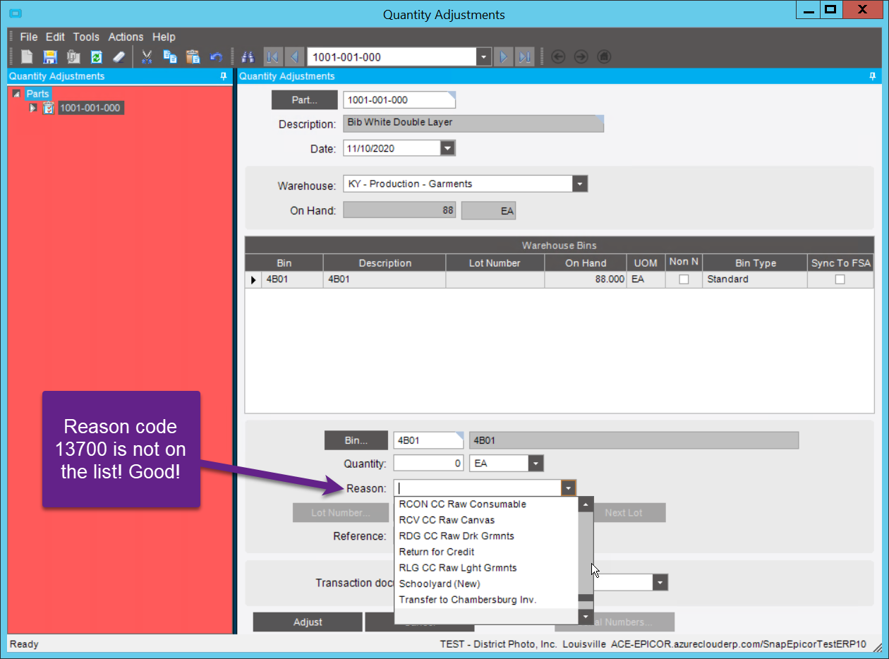

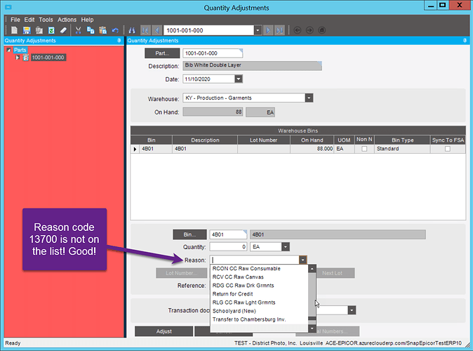

  3. Create BPM on Erp.Reason.GetList to filter where Reason.Inactive_c = 0. This only removes inactive reason codes from the list. See below Screen Shots
So what’s the point, right? Well, we are trying to prevent folks posting with a key’d in reason code that have been marked as inactive. See video of this behavior with items 1-3 implemented linked HERE.
I want to create a BPM to validate that the reason code that is keyed in is valid. In screenshots from step 3 above, reason code 13700 is marked as inactive and does not appear on the drop down. BUT! As seen in the video in this step, you can see the user is still able to post a transaction for a reason code that does not appear on the list.

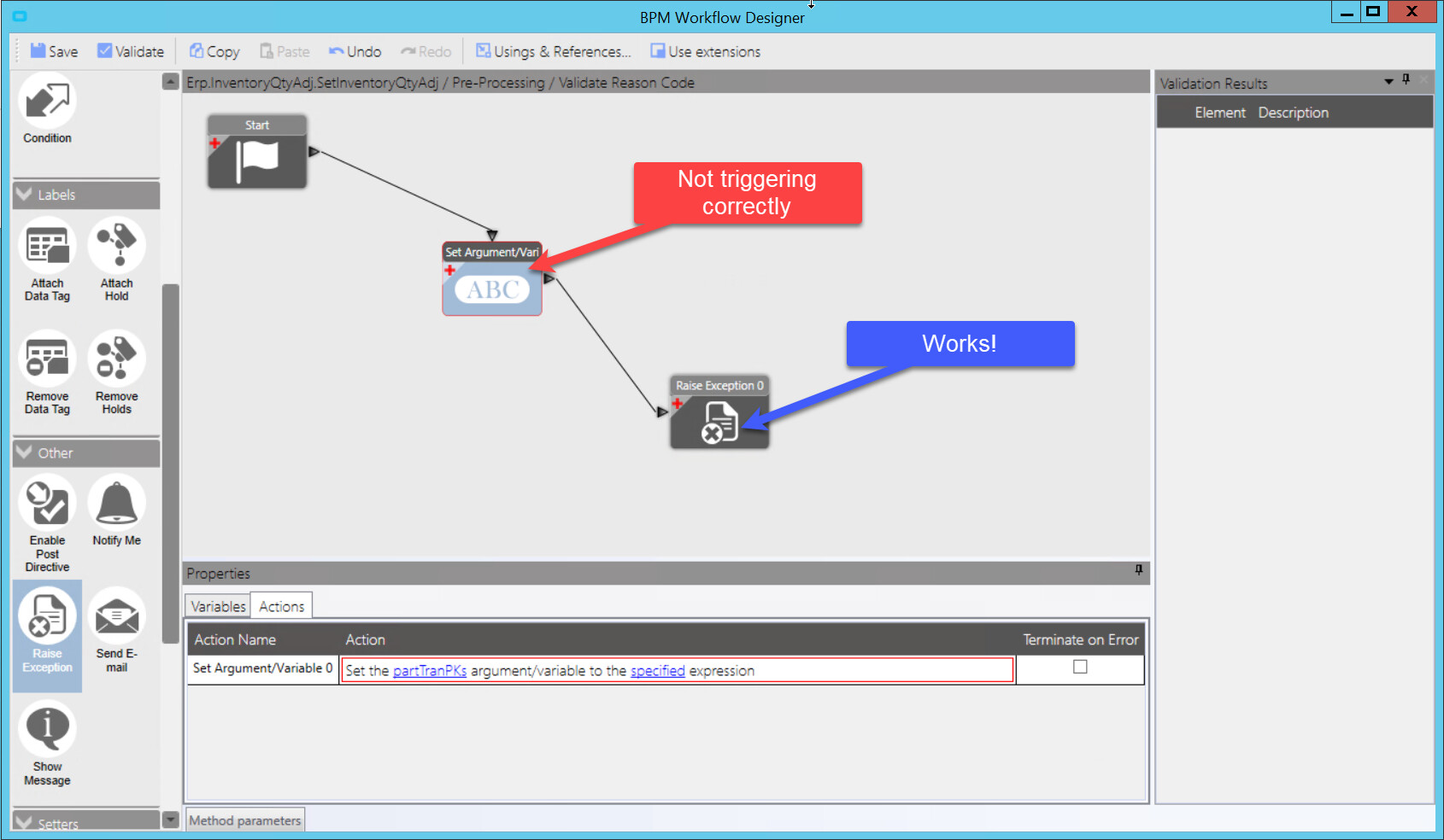

  1. Through a trace, I determined that the correct method is Erp.InventoryQtyAdj.SetInventoryQtyAdj but I’m not sure what the correct BPM would be. I do not want to prevent the users from being able to type into the field for numerous reasons, but mainly that we have 50+ active reason codes (don’t ask, I just work here LOL), so it’s faster to let people key in the one they need. So, a BPM that would validate the reason code and display an error is most desirable.
Here’s what I’ve got so far:

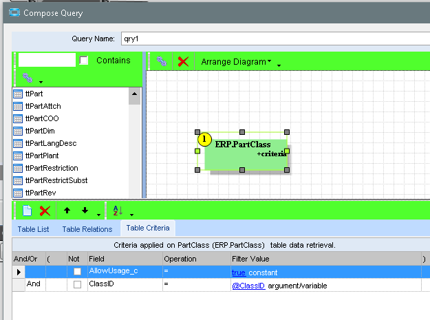

  1. Create a variable to hold the Reason code
  2. Use a “Number of rows in query …” condition.
  3. The query will conists of a single table (reason code for you), with table criteria to limit it to records matching your reason code and your Inactive_c field
Note that my example has the bit field as “Allowed”, so the table criteria is “true”, your’s should be false.

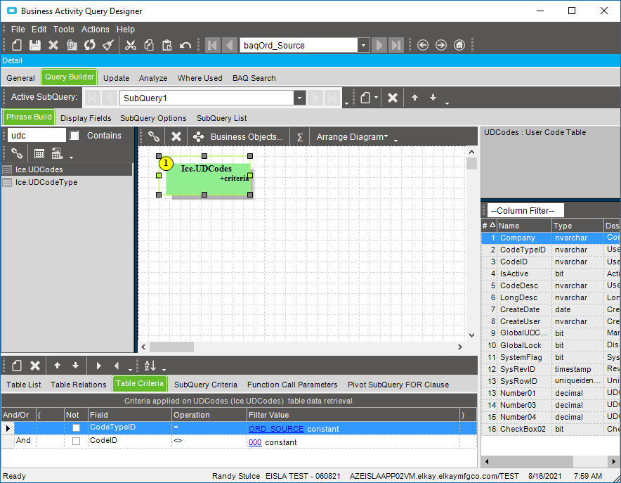

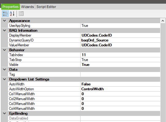

Can you make a BAQ then use a BAQ Combo?
Thanks for jumping in, Randy. Actually, I did make a BAQ for this purpose, but couldn’t figure out how to configure it properly.
Do you mean you couldn’t configure the BAQ or get the BAQ Combo to work? Edit: Just did a quick demo as it’s been awhile since I used a BAQCombo. :slight_smile:
Settings for BAQ Combo on form:
BAQ:
