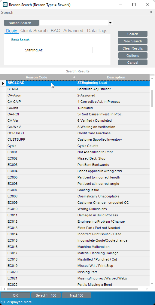

Have you had any luck getting this to work in 2022.1.3? Nothing happens when I created the BPM and tried to look up rework reason codes.
Have you been able to get this to work on 2022.1.3 its not hiding anything when I changed the R (Rework) reason code and alter where to match our reason code description?

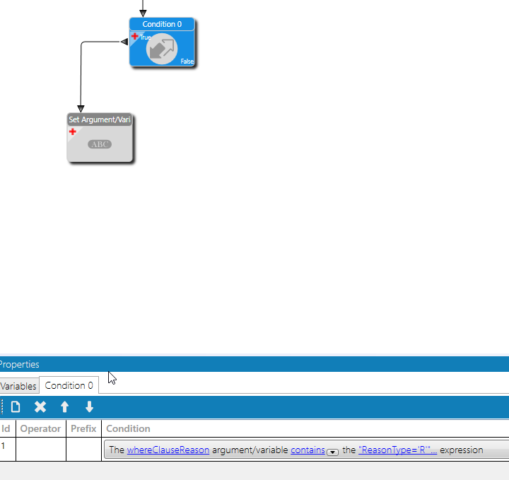

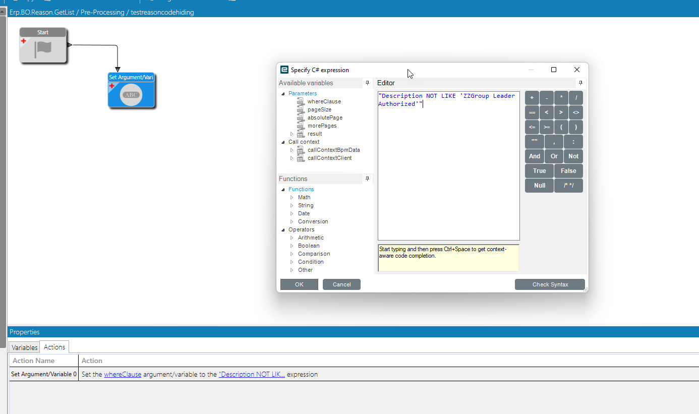

Here is the BPM that I was using. I also tried putting in a condition on a different test to only filter on the Rework reason code. What we are wanting to accomplish is hid reason codes with ZZ in front of the description since they are no longer used.
FYI exporting the BPM is not really the preferred way, usually screenshots of the code or pasting your formatted code is the way. I’m certainly not going to import it into my environment
Okay, my bad. Here is a picture of the code. Not too different than what your picture had.
Coool, is the BPM enabled?
The other thing to check is you might need to have the same exact BPM on GetRows too
Have you tried running the BL tester to see if your where clause works there? Sometimes it’s easier separate the parts of the problem to troubleshoot.
I made sure the BPM was enabled and created a BPM for GetRows and that brought all the reason codes in when searching for a specific reason code. I have tried to filter by specific Reason code but that does nothing.
