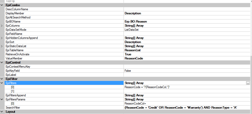

I’m sure like others, we have Reason Codes for RMA, Scrap, etc areas that have for one-reason-or-another been needing to be “disabled” and no longer show up in the pull down. In this case, I was lucky we only had two valid reasons to display and I was able to get some help to this filter working:
EpiFilter: ReasonCode = ‘?{ReasonCodeCol,’’}’
EpiFilterParams: ReasonCodeCol=
SearchFilter: (ReasonCode = ‘Credit’ OR ReasonCode = ‘Warranty’) AND ReasonType = ‘A’
My question --for future use-- is there a wildcard in the filters available? ie: ReasonCode <> ‘ABC%’ that would exclude any codes that started with “ABC”?

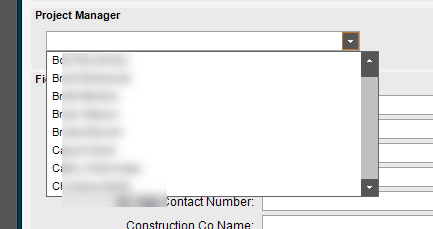

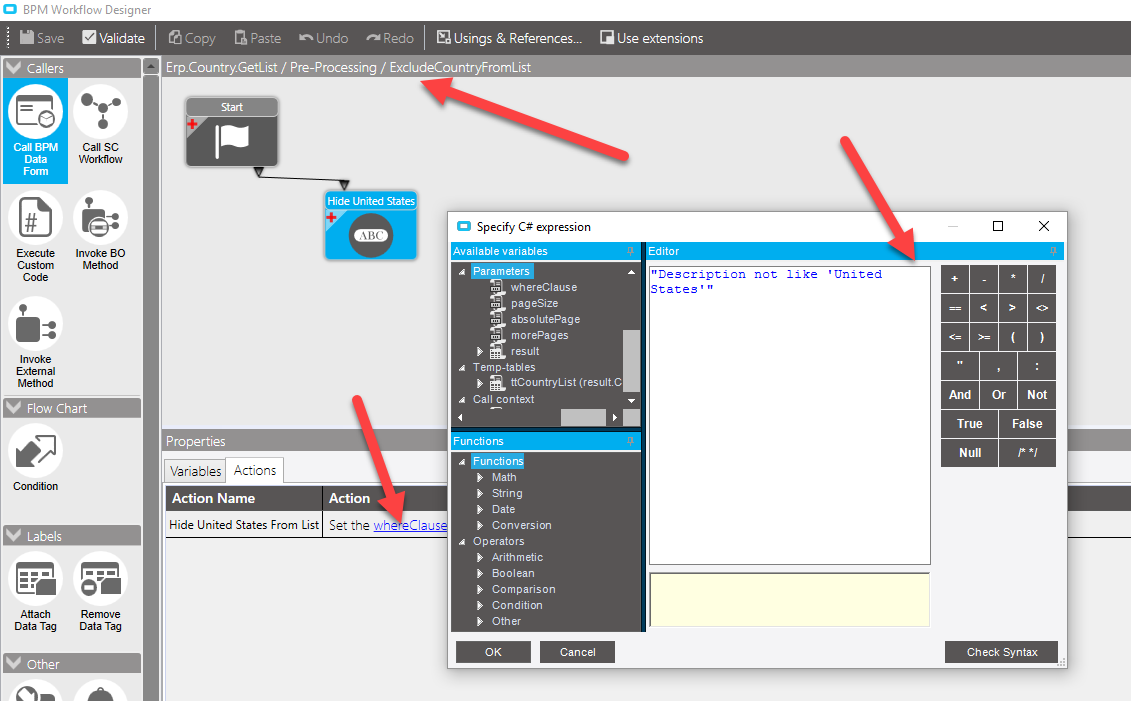

I did something like this with Country’s by setting the whereClause to exclude certain countries

That’s actually the filter I was trying to use. :wink:
It’s a common issue I’ve seen at every company where we’ve used Epicor. The UD checkbox to filter I’ve seen before, was trying to be clever and find another way. But alas, @Aaron_Moreng had the clever idea.
I’ve added a custom field like “Inactive_c” to many tables like ProdGroup, PartClass, etc… Then anywhere a user can select an entry from that table, I add a filter for Inactive_C = false.
This is close.
Here’s the syntax:
And the result (all of the names starting with ‘A’ are gone)

For our use @hmwillett had the answer, the filter needed “NOT LIKE” instead of what I was trying; <>.
