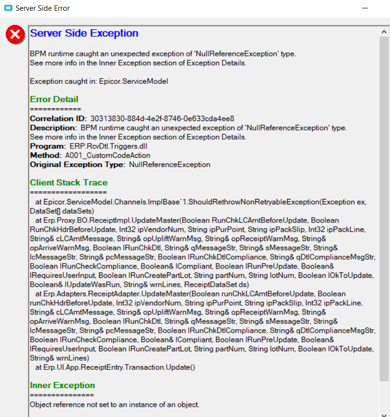

Our company had a BPM written for us by a consultant which is throwing an error. I’ve found a data directive with custom code on the Erp.RcvDtl table. Is there a way to find out which line of that custom code is throwing the error?
We are on premise if that matters.

Thanks for all the advice. It sounds like it takes code analysis or trial and error to find the offending line. Seems a bit primitive, but I guess that’s the way it is because of the way custom code is integrated into Epicor.
