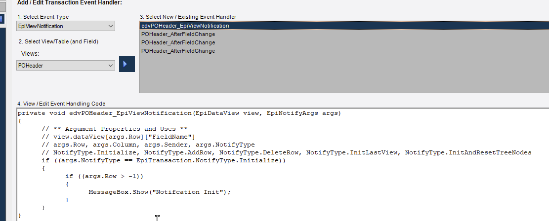

I have tried using the AfterFieldChange & AfterRowChange events to fire a function but for whatever reason they are not firing…

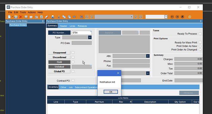

I open the form
i enter a PO number and press tab. To me, this field has changed but nothing fires on this action. Its not until i change it again does the event fire? I need an event to fire on the first change / update of the field.
AfterRowChange doesnt appear to do anything. even a rudimentary messagebox doesnt show…
I Also tried AfterAdapterChange but i couldnt get that working either…
So, what do i use to fire an event when a field is first updated / changed/ edited / entered?
