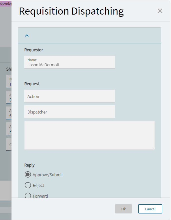

The irony is that it can cut off a critical part of a Kinetic form - without the ability to scroll to it. For example: dispatching a requisition. Users wondered where the buttons went. You had to unzoom back to 100% to see them.
No idea if they ever fixed that. Was I supposed to report that…?
if you have an example of something going away when you zoom in, we need to know about it. our intention with the screens is that zooming should work (within reason).

Here it is in 2023.2. The necessary controls (Action and Dispatcher) are not visible, but I can scroll to them.
The tricky part is knowing that they are down there. No scroll bar appears right away.
In March of this year we were on 2022.2 and scrolling did NOT work, according to a user (I just dug up our internal ticket). But I succeeded in scrolling in 2023.2.
