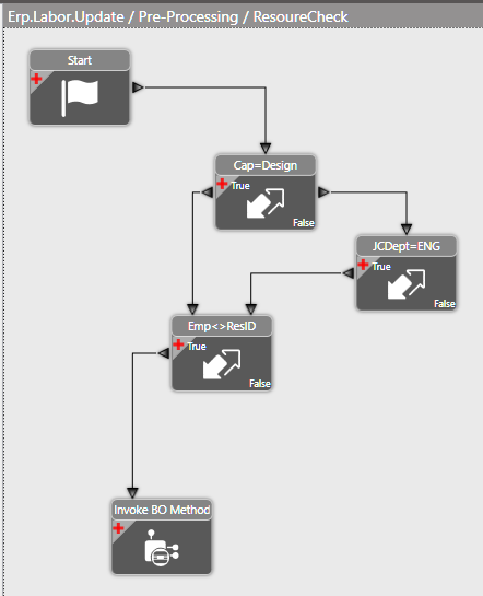

Now that I’m back from Vegas and had some ā€œfreeā€ time, I managed to work through creating a BPM to do what I needed. I’ll attempt to explain my requirement and how I tackled it for future reference.
We have 2 different Direct Labor ā€˜pools’; engineering and everyone else (MDL). These pools have different burden rates and have to be segregated for financial costing reasons.
The Facts:
  • Direct labor is directed to the GL via Departments
  • Burden Rates are set by Resource Group
  • We use the scheduling engine and capabilities to assign resources to an operation
  • MDL is never allowed to clock into Engineering Ops
  • Engineering is allowed to clock into non-engineering ops, but must use their GL’s & Burden
  • Normal functionality is that anyone can clock into an ops even if it is not assigned to them, however, the scheduled resource, resource group, and JCDept stay the same.

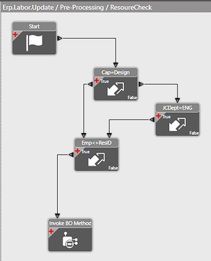

I created a Method Directive BPM on Labor.Update Pre-Processing, which Invokes the Erp.Labor.OverridesResource BO method, if;
  • (the CapabilityID equal ā€œDesignā€, which is the Engineering Capability OR
  • Emp’s JCDept = ā€œEngGroupā€) AND
  • ResourceID <> the EmployeeID
The only piece of custom code in this BPM is the JCDept=ENG condition, because I couldn’t get it to work with a BAQ… The code is:

I’ve tested this with a bunch of different scenario’s and if seems to work perfectly, as long as the engineers are a resource in the capabilities they are clocking into.
Here is the export of the BPM (Verison 10.2.200.8) Labor.Update.ResourceOverride.bpm (43.0 KB)
