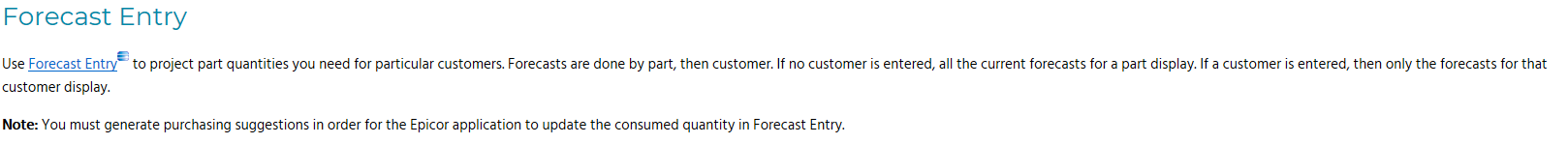

Might be a daft question but we are only live on Vantage at the moment (we did use Forecast without issue but don’t anymore) and working towards E10 live implementation, but the help advises this:
Have you generated purchase suggestions?

Maybe worth trying to run it though as that’s what the help is suggesting, even though it won’t affect any materials?
