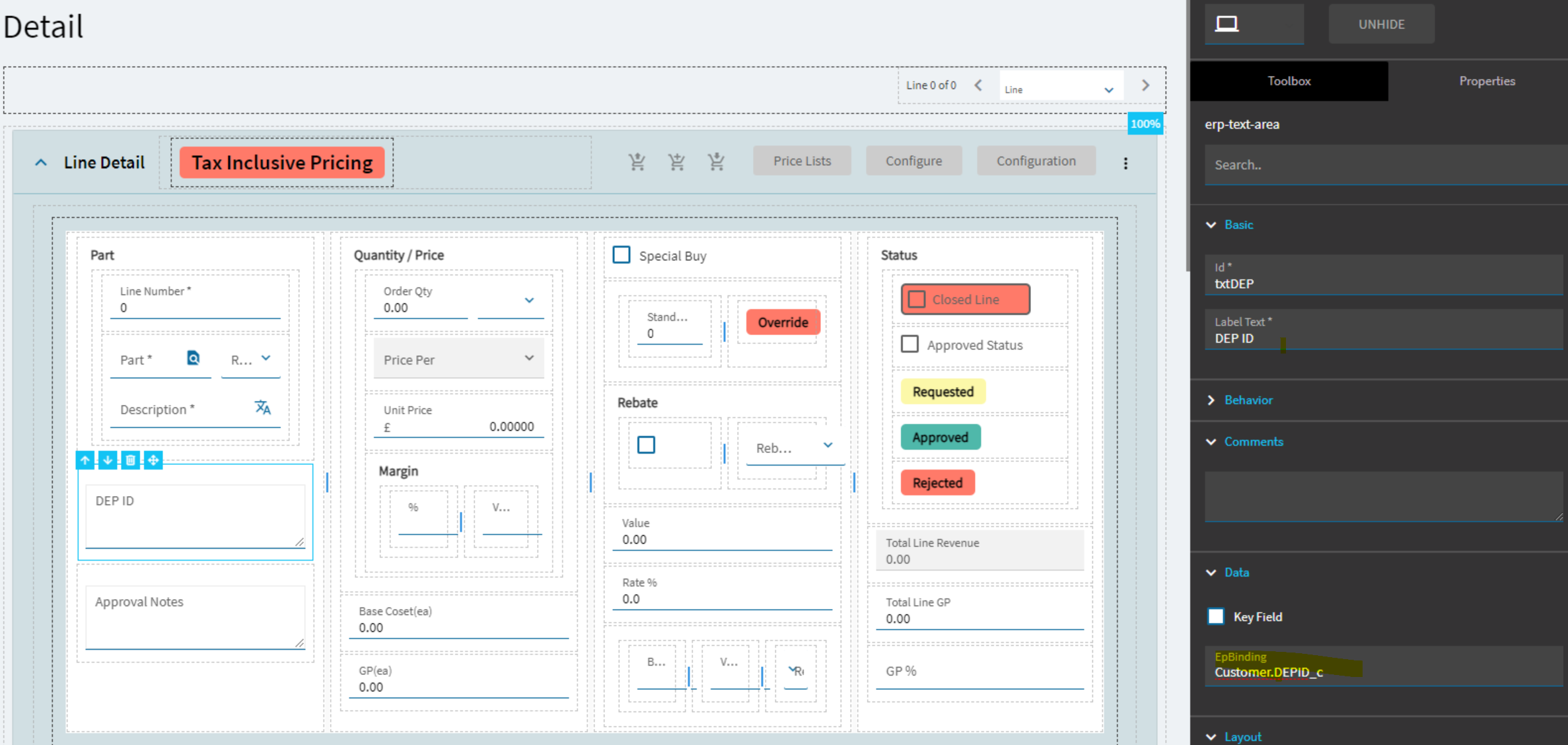

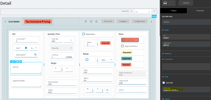

I have created a Data View which i think is correct:
Then just binded the field to my text box
But when i preview the screen, none of the data appears in the field and i am not sure what i am missing to get this to work

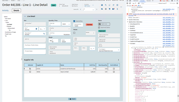

If you open the console and dump out the dataviews (CTRL-ALT-V) can you see whether the Customer view / column is populated?
Example screen shot:

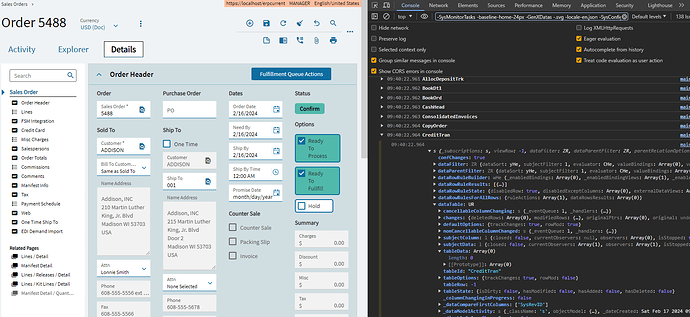

Doesnt seem like the data is populated:

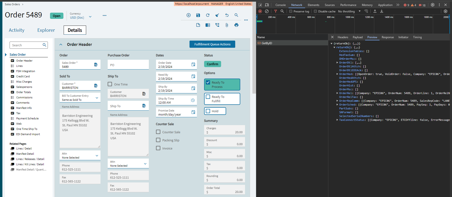

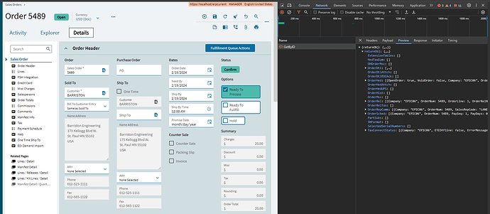

Hi Ben, sorry, if you hit F12 when you are in the browser it will open the console and if you navigate to the network tab can you see what tables are being retrieved from the bpm / customization you have in place to retrieve the Customer table?
Hi @NeilTaylor
Yeah the Customer Table isnt in that list for GetByID
