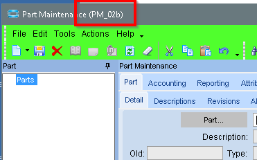

And FWIW - I always change the title bar of customized forms to include the customization number.

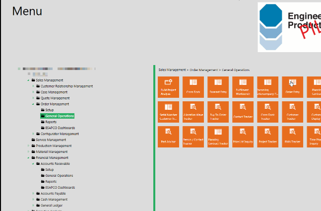

Are people launching from Favorites or Recent list? Does it happen if they launch from the Menu too?
My testing used both recents and directly from menu items so yes to your final question.
