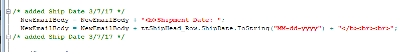

I get “There is at least one compilation error. ” when trying to save with the .ToString(…)
ckrusen
(Calvin Krusen)
March 7, 2017, 7:09pm
8
With
I get an error when trying to save the Data Directive
