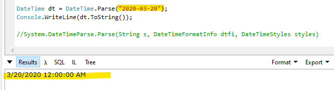

Hi there,
Always use the The ISO 8601 format YYYY-MM-DD (2020-03-20).
That has never failed. Also, remove the time, I’m not sure Epicor accepts it on Date columns.
