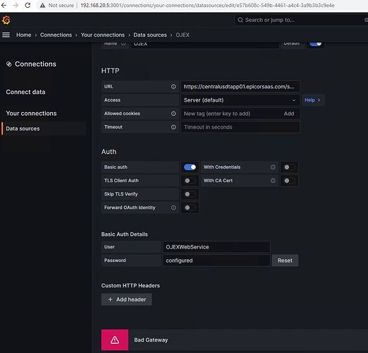

I want to pull this datasource into Grafana to make some charts. I added a SimpleJson datasource to grafana, and configured it as follows:
No matter what settings I choose in the setup here, I always get “HTTP error”, “Bad Gateway”, or “HTTP error Forbidden”.

I don’t use Granfana, but have used the REST interface quite a bit. Have you tried changing the api-key param to x-api-key? Or removing it from the URI and adding it as a custom HTTP header instead?
Also, the username/password has to be base64 encoded - I don’t know if Grafana does that for you?
Edit: just noticed that the “With Credentials” toggle doesn’t appear to be on in your dashboard, so I don’t think they’re being passed.
I have tried that With Credentials flag on and off, in browser and server. I just tried pulling the api and inserting it as a header. Admittedly, I don’t know what I am doing, but it didn’t work. I am hoping that grafana does the encoding, as when I enter a password it replaced it with password dots, then when I reload it just shows that “configured” word in there. I think that means that it took my pw and saved it encoded somehow.
Hmmm…If you open the dev console and watch the Network tab, you should be able to see the call, and if the username/password is being passed encoded or decoded.
Edit: you could also try using V1 of the REST API. I’ve had trouble with V2 in the past.
He’s passing it in the url, so it is api-key.
Got tripped up on that one myself a few days ago.
Headers: x-api-key
Url: api-key
x-api-key in the header is more secure.
