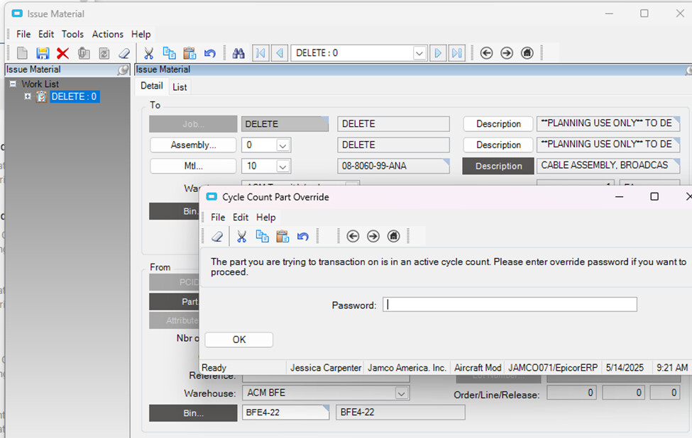

So here you can see the cycle is only scheduled, tags have not been generated or anything, I had only performed part selection.
We only want our parts to not be transacted when the count has started, but still want to transact prior to the start of count. Is this ideal or not?
I added the part to a fake job and tried issuing it and the warning pops up -
Yes, that looks like a BPM is firing that is calling that up, it is not a normal part of the base program.
If you really do want to go down this route of actually blocking Mtl transactions like this then you would need to adjust your criteria in the BPM to look at something like the snapshot field to see if it is more than 0.
