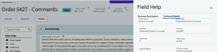

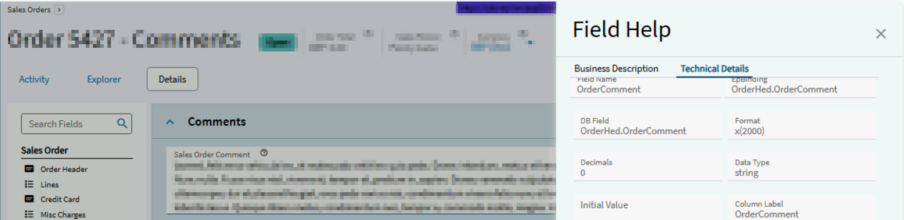

Here’s my idea: Change field format behaviour: “x(1000)” should not mean “unlimited”
As I’ve found out recently when defining a fields format of “x(1000)” in Extended Property Maintenance, Kinetic does not enforce the character limit.
e.g. You can set the OrderHed.OrderComment format to x(1000) but still able to enter 15,000+ characters!!
Looks like it’s been discussed before as well: Change in Field Default Format x(1000) behavior noticed on ECOOpr.CommentText (limited to 1000 chars in front end)
This is because from legacy coding dating back to E9, where “x(1000)” is treated as “unlimited

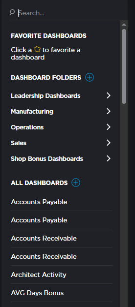

Here’s an idea I put in for Grow!
Make All Dashboards a folder so it can be collapsed for a cleaner view
In Grow they provide the ability to sort dashboards into folders, this works great except there’s a list of All Dashboards right underneath the folders that lists every dashboard a user has access to in alphabetical order.
If you want dashboards sorted within a folder, you might label them 1. Outside Sales 2. Inside Sales and if you do that in more than one folder the All Dashboards will end up with several 1. xxx dashboards stacked together. If they made All Dashboards a folder that was collapsed by default it would make this a much cleaner look overall.

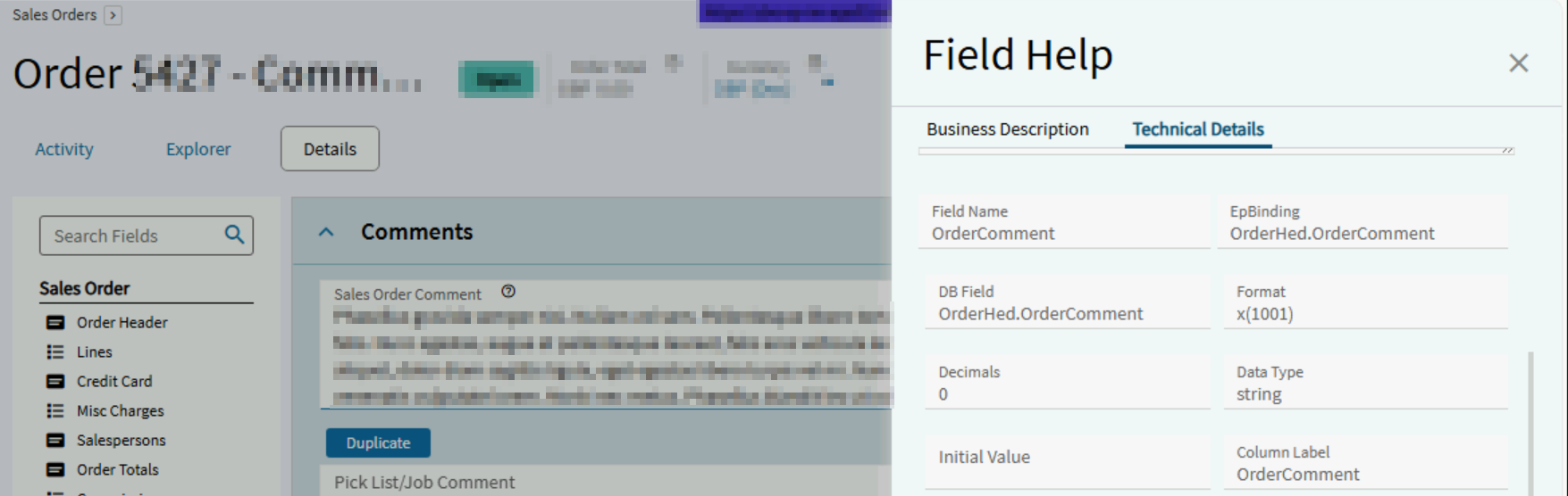

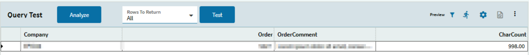

Interesting question and I have never tried this @alex.ball what happens if you use X(999) or X(1001)?
I believe EKW or POD Light allows sign on glass functionality. Perhaps an EKW licence is all you need.
It appears that x(999) does enforce the limit.
But x(1001) does not…
And I’m not using a UD field. I’m just using the standard fields, but you should be able to enforce a limit if you wish.

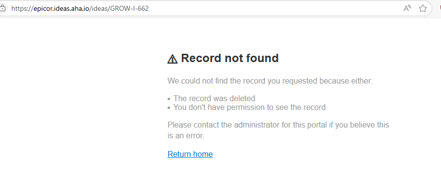

I sent it to my colleague here and she was able to see and vote for the idea. I don’t know if they’re just immediately available within the submitter’s organization or if it got reviewed after you looked at it. Do you mind trying it again to see if it’s available for you?
It doesn’t show for me:
The most recent one to show up for me is from 13 days ago:
Yes, that is how it works. If you hover over the lock symbol on the idea you will see.
You’d have my vote if they’d open up the idea so people could vote on it. Only people in your organization can see it until its an approved idea. Hint Hint Epicor…
