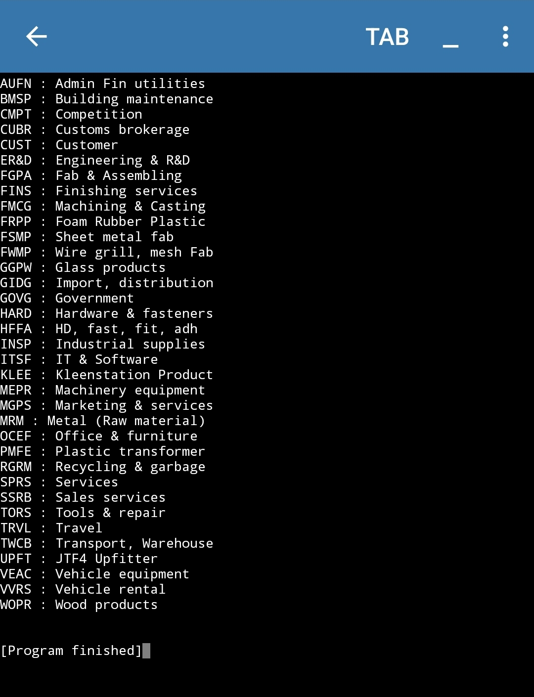

This prints out the contents of our vendor groups table, needed because the Vendor object only contains the GroupCode and we have to look it up.
Py3 on my phone, just in case anyone mistakes me for someone with a life
