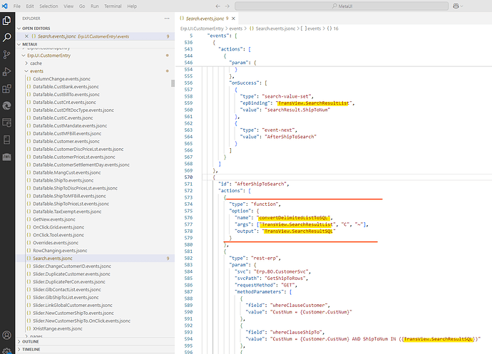

Looks like it’s simply reformatting the tilde separated list to a single-quoted, comma separated list valid for a SQL IN() clause.
I wonder if “C” arg means comma and perhaps there are other, more advanced options such as OR LIKE ‘{1}%’ OR LIKE ‘{n}%’ etc

convertDelimitedListToSQL is really just pure UI function, so this is question to UX team, not for Patrick and I.
Description is:
This function gets a SQL compatible list for use in SQL where clauses. Example item one~item two~item three~ -----> ‘item one’,‘item two’,‘item three’ OR 1~2~3~ -----> 1, 2, 3
