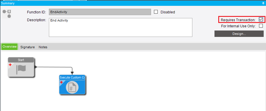

I am writing a function to automatically clock out employees after x number of hours clocked in. In the function I have a custom code block that loops through header records where ActiveTrans = true, then within each, loop through detail records where ActiveTrans = true. I call the EndActivity then Update methods for each activity, the same way that MES would.
For each method call I am using the CallService() method.
The problem I am having is that the first use of CallService works fine, but if I use the method a 2nd time, I get the following error: System.Data.Entity.Core.EntityException: The underlying provider failed on EnlistTransaction. —> System.PlatformNotSupportedException: This platform does not support distributed transactions.
That is an Entity Framework/SQL error that I don’t know how to get around. I’m surprised to see this since I am not performing any Add/Update/Delete transactions directly using the ‘Db’ database context.
Any ideas on how I can avoid this error?

I enabled the ‘Requires Transaction’ checkbox on the Function and that fixed it. I had always skimmed past that checkbox before, never looked into what it was for. Shame on me.

I enabled the “Requires Transaction” checkbox on the Function but getting the below error

I have found that when enabling the ‘Transaction Required’ checkbox, you should not also use the TransactionScope in the code. Try removing the using(var txScope… statement from your C# code and try the function again.
It’s superfluous at best to use both. The checkbox just wraps your whole function within a TxScope.
You use the TXScope code block if you want the system to rollback some but not all changes if you run into an error. For example, I have a routine that updates certain jobs to the newest part rev. It loops through each job and runs a number of method calls. The TxScope is within the loop, so if (for example) someone transacted something on that job, the update on that job will throw an error and the system will rollback my method calls. The loop then iterates again and the process begins fresh on the next job.
If I used the checkbox, the system would roll back changes made to every job in that function up to the point of the error and then stop trying to update jobs afterwards.
If you’re not looping like that, or you want to roll back everything, then use the checkbox.
Removed the Transaction Scope from Code. But still getting the error when i use CallService in the code. Is there any other way to call the methods
