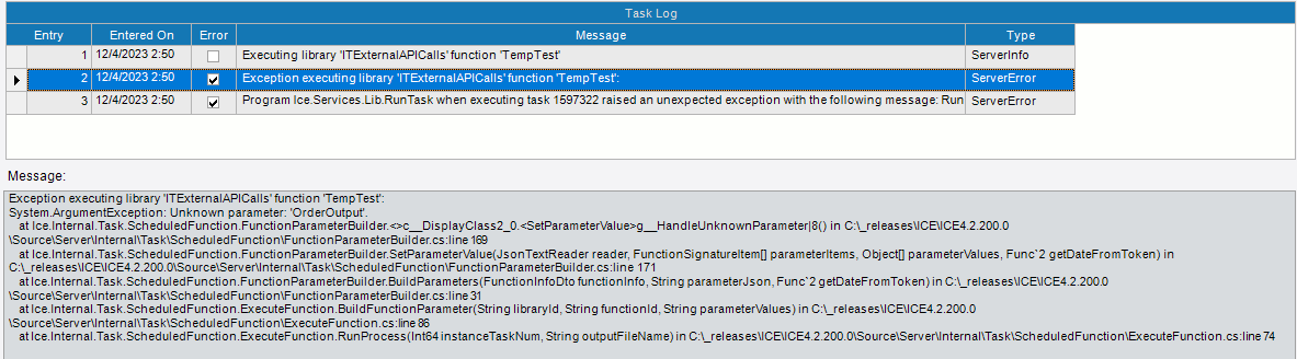

Functions Outputs stopped working on our test system
I’m afraid to play around with them on Live in case the same thing happens, but randomly our Functions on the test system stopped working for any that have an output variable. I can’t create new ones with output variables either; they save fine but when ran through Schedule Epicor Function it errors in system monitor with a generic message: “System.ArgumentException: Unknown parameter: ‘PriceBreaks’.” or whatever the variable name we gave it was.
Anyone run into this before? Hasn’t been an issue in the past - the only thing that might have happened since last developing on our test environment was refreshing it with our Live environment. But currently our live environment runs functions nightly, with outputs, and it works fine.

For anyone else interested in the future to match up error messages:

We’ve seen this it’s some sort of cache. Reboot usually fixes it or IIS Reset

The workaround is to create a wrapper function without output params, and schedule it to call the main function. That works for us.
// Function: "CallMainFuncName"
try
  //discard results
  var result = this.ThisLib.MainFuncName();
catch(Exception ex)
  throw new Ice.BLException(ex.ToString());

Occasionally there is a bug with parameters.
The solution is to export the library and edit the json if it’s totally screwed, or sometimes just reimport as is.

I wish I would have remembered to update this with our solution - but I would agree it is some sort of cached data. I believe a full restart with a full IIS reset as suggested fixed it for us but I’m not 100% sure at this point.
